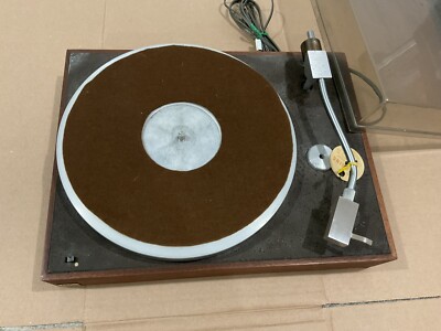

I've been eyeing this table for awhile, one province away. It was still available when I flew over to visit my folks. Not a bad deal. It was previously serviced by a shop. However, it still needs a bit of servicing and adjustments. Belt seems new, so that is a plus. I will tear into it when I get a chance.
I am quite excited!
The good:
-condition, not too shabby. Dust cover is pretty good!
-everything works
-RCA cords were replaced
The neutral:
-non original headshell
-came with an Ortofon 2M red
-original felt mat is a tad poor looking
-different colour hinges
The fix:
-motor is noisy on start up but fades away. But, noisy when no load is on the motor. Sounds like oil will fix it.
-suspension was not properly tuned, so I will have to do it.
-tone arm needs fluid, drops like a rock.
When I get it back to BC, I want to see how it sounds against the Ariston. The XB I had to was nice too.
