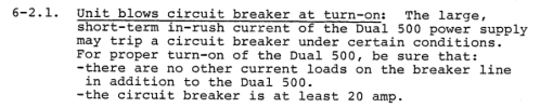

this hungry monster amplifier prefers a 20a circuit, looking forward to measuring the inrush with my scope. 117v mains might be the ideal voltage to apply which would make 120v (the residential "norm") slightly over-voltage condition. need to measure rails at various mains voltages to evaluate further. power filter caps rated for 125v and it would not be too difficult to exceed that.
15 amp mains fuse obvious is a safety restriction but it also will not allow the amp to function to its max "rated" output, if the above is accurate. although 120v * 15a = 1800w assuming power factor of 1. if it takes 1800w to produce 1010w stereo for audio purposes that would be 56.11% efficiency. still better than pure class-a but the electric bill is going to rise depending on long term volume levels exercised.
highlighting the bias range which is quite wide. although if hi-z is set around 380mv and lo-z measures somewhere above 300mv that would fit perfectly.
"may trip", more like it will trip since there is a high probability of other devices being on the same mains circuit that are actively consuming power. how many households in the late 70's had a dedicated 20a breaker or circular fuse to handle such an unrestricted inrush. whole home brown-out when turning the amp on after letting it completely discharge.
