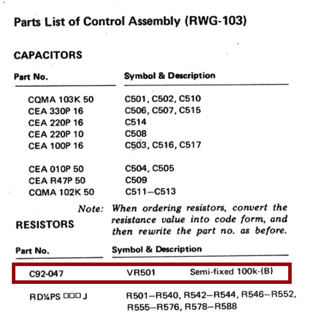

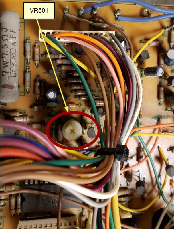

VR501 is marked on the main schematic page (12.3) as "Clock Freq. Adj." There should be no reason to mess with this. It adjusts the voltage on pin 13 of IC501. Have read through the discussion of the control circuit twice and I find no mention of VR501, IC501 pin 13, or how that control is to be adjusted. There is a test point on IC501 pin 13, but with no specification given for the voltage, we have no way to know what it's supposed to be. I really hope you didn't diddle that pot!

The first post here is to see if anyone knows what the POT on RWG-103, VR501, calibration should be?
Check out the attached picture I took from a perfectly operating CT-F1250. Measured at the TP near VR501. The frequency is 13.0569 MHZ. Should be close enough as this unit was untouched.

Thanks, Neil! That's what I was looking to find. No manuals that I have found specified this, although I did confirm rohoknox's mention above. Overall, I've found these decks to be easily serviceable, from the mechanism to the discrete electronics. Occasionally, I'll find a bodge (like with the CT-F900 control board that stops a feedback in the logic circuit from randomly going into REW), and have to figure it out myself. All of these adjustments, I suspect, came out in some sort of service campaign or bulletin in the 70s or 80s; but those documents are likely long lost.
