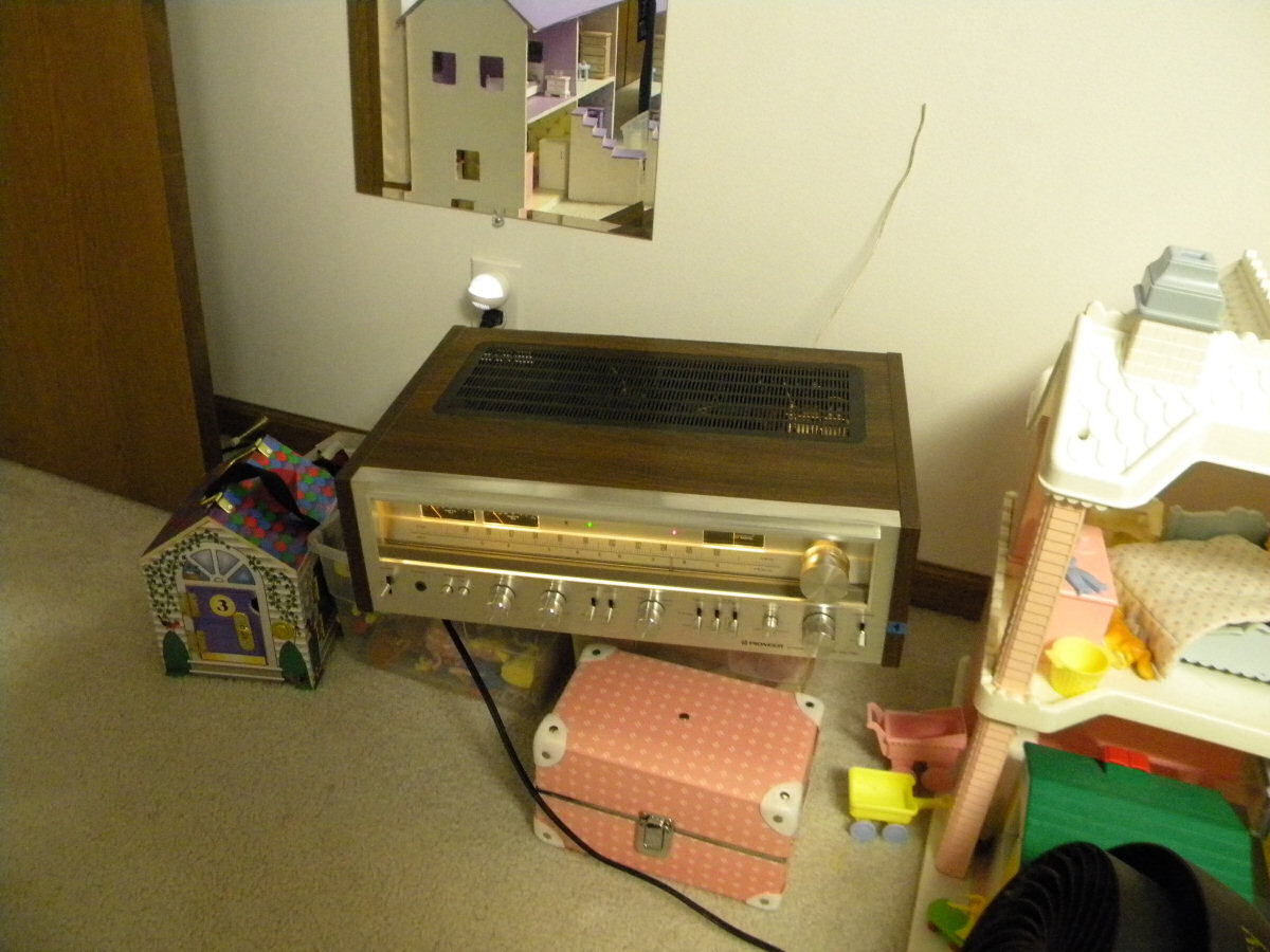

In lieu of a thousand words:
I grabbed one of my 780s out of the stack and plugged it in at the grandkids' play room (AFCI). It hadn't been run for a while anyway. I'll leave it on for several hours just for grins, but it engaged the speaker relay about 4 seconds after power-up, just like always.

Thanks for the pic! If the grandkids know what good audio sounds like, they'll ask you to connect up some good speakers and leave that 780 right there!

Unfortunately, the 780 is still running (no speakers) at about 30% volume with no problems. I don't think it's a design problem on "normal" power and doubt that the ACFIs are affecting it much, if at all. I've got a Schneider/Square D load center, so it's pretty mainstream. I don't know if Eaton, C-H, or any other equipment has demonstrated problems in this area, but haven;t researched them either.

It's been about 6 hours, and the 780 is doing just fine at about 1.5W on the VU meters.
I would say you probably have the all-clear for the AFCI working okay with your SX-780. I ran my original SX-980 at home for about that same amount of time total. I pushed around 60 watts peak for a couple hours (according to the meters, at least) using these monsters:
