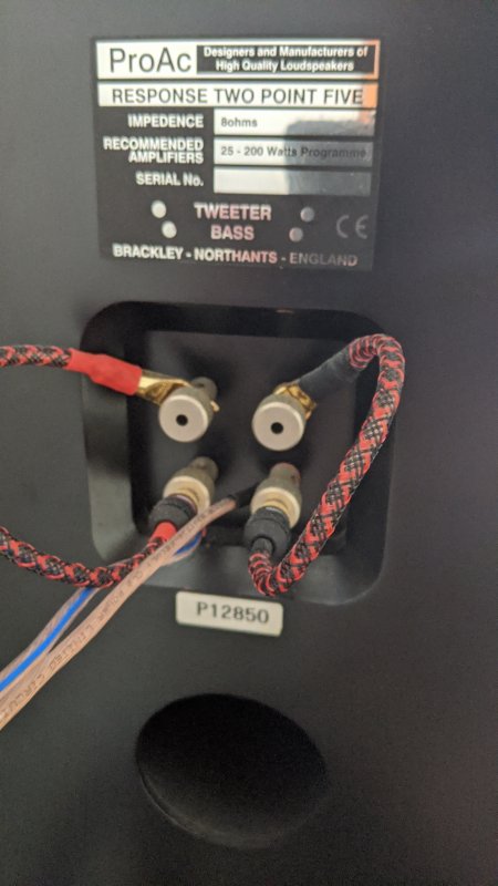

Early 2.5's didn't put serial numbers on the name plate above the terminals and left them blank. These had a sticker under the terminals with a number starting with the letter P These also didn't have the ProAc embossed woofer baskets.
I've seen a pair with serial on the name plate in the low 100's that didn't have the wider ProAc basket. but seen a pair in the 400's with the wide ProAc basket. So somewhere in between those they made the basket switch.

Thanks, Mike. All good info. I wondered about 2.5's with no serial number on the name plate and just a little white tag.

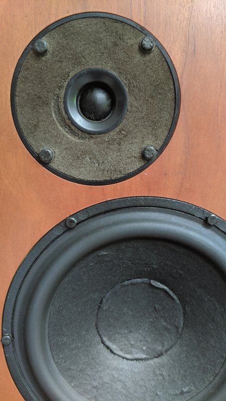

Thanks to Mike and everyone else here. I'm a new owner of a pair of ProAc Response 2.5's - apparently from an early run. Hope to get guidance on a few questions.
  1. The foam on the tweeters is pretty ugly. I see Mike posted a link to replacement foam. How to replace it without damaging the tweeter? The adhesive is pretty strong. Is there anywhere to get the foam with the ProAc logo printed on it?
  2. I was told at purchase that the speakers should be positioned with the tweeters leaning in - towards each other. Is that correct?
  3. I've never owned speakers this old. Is there any sort of maintenance or upgrade that should be done? Replace the tweeters? Replace capacitors in crossovers?

Lovely speakers, Rapide, when they get best amplification. I had a pair in Cherry for 10 years, 8 in the States and Two here in NZ where I live. I used a light oil called Tung oil every second month. They glistened. (keep away from spkrs or surrounds.)To the issue of tweeters in or out? I was told at a Shop in Portland to put them away and not toward each other. It made sense and a better image.
These puppies need a good solid state amp with high current. I tried VTL tube amp generating 45wps in Tetrode and 15 in Triode. Excellent mids and high freq response, lacking strong bass, just ok. Then I got a Plinius SA100mk3 and they sang like not before! Then I heard Dynaudio C1 Signatures and few years after arriving in NZ sold the 2.5's and got the Sigs. WOW what a difference. Have upgraded the amp on a trip back to States with Ralph Abramo in Riverside area. Double wow! The 2.5's are making a local kiwi audiofool plenty happy. He has not done any repairs to speaker surrounds and uses a Plinius 9200 integrated on them. These are definitely worth restoring. Some kind of magic, especially on Classical and acoustic jazz. Enjoy Alejandro
Most important.. check the drivers individually for correct ohms.. and do frequency sweep to compare with each other. Sticking your ear against each working driver... not good enough. 2.5 woofers (modified Scanspeak 18W 8535) have very few issues other than surrounds. Tweeters ( modified Scanspeak 2010/8513) ... well.. good luck. The cooling ferrofluid tends to dry out and thicken over 20+ years of use and exposure... thus numbing and rolling off the high freq response. Some 2.5 tweeters just die even without abuse.... actually same with various older Tablettes. Personally.. I would not replace with Madisound or Falcon sourced Scanspeak subs. Supposedly Proac, working with Scanspeak, had the basic drivers modified to their spec. (Subject of heated discussion) Proac 2.5 tweeters are currently about $360 a matched pair in the US. If you buy cheaper generic subs, you will be endlessly wondering and making excuses.
Madisound $8 tweeter foams do not have Proac logo.
I have heard many at Proac UK are working from home due to virus... so no one answering phone and delays in providing tech support. In US, best to work through local dealer or distributor Soundorg in Texas (Cole & Rick - cust support). Canada also has an Excellant Proac distributor.. (Alex Tiefenboeck) Crown Mt Imports. I am 6+ hours from any dealer or would support my local first.
You can roughly measure ohms of woofer directly at rear terminals. (circa 7.8) You cannot ohm test the tweeters as capicitors in their crossover branch.... must remove tweeter from cbnt and unsolder one lead. (circa 7.3 - 7.5)
Just play with toe in & out and tweeters inside and outside. A Lot depends on characteristics of room and seating position. If no option but near a back wall or corner... a sock temp stuffed in rear port will bring less boomy bass.
Yes.. P 12850 from early series. Later run mostly a woofer basket change. I have P 14031 (early series) and R 25/001491 (late).

So for research sake... My Response 2.5 has the sticker serial number (P12850). / Does not have the embossed woofer. / and the tweeter attachments are a type of hex head screw / bolt (?) and won't take any sort of bit. Although the foam is chewed up on the tweeter it appears to never have had the ProAc logo.
Tweeters ... well.. good luck. The ferrofluid in the Scanspeak 2010/8513 tends to dry out and thicken over 20+ years of use and exposure... thus numbing and rolling off the high freq response. Many 2.5 tweeters just die even without abuse. Actually same with various older Tablettes. Personally.. I would not replace with Falcon sourced Scanspeak subs. Supposedly Proac, working with Scanspeak, had the basic drivers modified to their spec. (Subject of heated discussion) 2.5 tweeters are currently about $360 a matched pair in the US. If you buy cheaper generic subs, you will be endlessly making excuses.
Hmmm. Sounds like they may be in need of a tune up. There is actually a dealer (listed on ProAc website at least). in my city. It sounds like that is the only way to get the original replacement part. I'd hate to pay a 400% markup for aftermarket ScanSpeak Classic D2010/8513 - if someone sent me a fake from madisound.com I wouldn't know the difference.

Foams can be bought through your country’s distributor but apparently they're stupid expensive. Just get the generic foam if you don't care about re-sale.
You may need scrape off the old foam and use goo-gone and some elbow grease to remove the old foam’s glue.

Very good news. Yes, the foams were nearly $100 US to have two shipped here - that was a quote directly from ProAc - not through a distributer.

Crossover is directly behind the woofer under a bat of insulalation, Wires are factory soldered to woofer terminals so be careful not to scratch baffle with the magnet.
