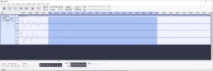

I also checked resonance of the last diaphragm before I removed it. I thumped it with my finger and recorded the drum-like sound. Then I opened the recording in Audacity and zoomed in on one of the thumps, counted out several cycles, and measured the time those cycles took. I got 98 Hz resonance. I checked several of the other thumps and got the same number. When I take the other speaker apart, I will check each diaphragm the same way before I remove it. When I put in new diaphragms, I'll figure out the amount of stretch to use to give the same resonance.

I did some study on FFT and decided to use the spectrum plot with a Hann window to read the resonance of the drivers. After testing the three good drivers in the second speaker, I came up with 92 Hz as the target resonance for new diaphragms, though I'm inclined to go a little higher to ensure adequate tension to prevent the diaphragms from sticking to the stators. The diaphragm from the first speaker that I used to calculate resonance from the waveform gave me 98 Hz just dividing the number of cycles of the waveform by the time they took. Using FFT with a Hann window gave me a 99 Hz resonance. I'd call that pretty good agreement.

I also came up with a reliably consistent way to thump the diaphragm to test resonance- I glued a thread to a steel ball bearing. I just swing it until it hits the diaphragm and record the sound, then run FFT on it in Audacity. The waveform is much cleaner this way than with my previous "drumstick" tool and the result is much more consistent.
