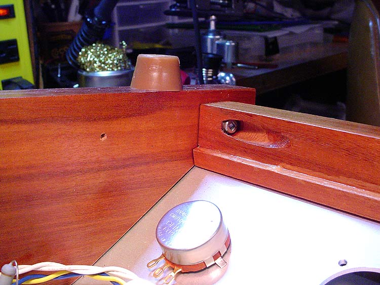

Invest in a pocket hole jig kit. Very strong - glue optional.
Great for dry fitting too. Also allows you to adjust the fit after the fact as the wood dries and settles in. From a recent project ...
