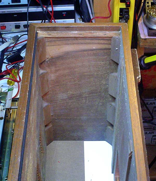

If I'm building a wooden chassis bottom, after it's all squared, clamped, glued, and dry, I will take scraps and make little wedges to glue and clamp in the corners for added strength.
Yup ... corner blocking is an excellent addition to any project if you've got the clearance. Here's the case of a Sansui QR4500 ... they weren't fooling around on this one ...
