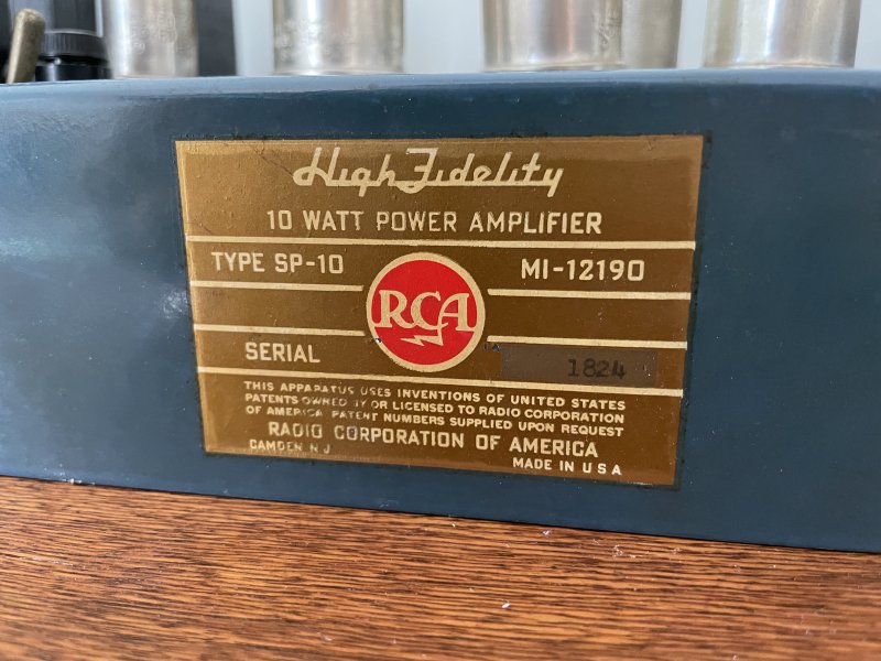

So recently I’ve been falling further down the rabbit hole of vintage hifi. What a tragedy! I’ve been hooked on the sound of simple, high efficiency speakers, idler drive turntables, and tube based electronics. My main amp for a while has been a Primaluna Dialogue, but I’ve been hunting for some vintage monoblocks.
the other day I came across a listing for a really clean pair of RCA SP-10 amplifiers. What little I could find on these amps got me very interested: designed by Harry Olson’s team in Camden, overbuilt transformers, 1/2% tolerance parts in the signal path. These were originally designed to mate with the SL-12 drivers, with the famed LC-1A matching the SP-20 amps. I knew they wouldn’t last long, and I knew my chances of finding a clean pair again were slim to none, so I jumped on them.
Naturally something this rare and obscure is going to require some attention before they can be powered up, and at the minimum will need a power supply recap. I’ve been going over the photofact, and studying the current state of the pair. One is entirely stock, down to the magenta QC marks on each solder joint, the other has a couple signal caps that have been replaced. I’m trying to decide how to proceed with the power supply caps, since neither CE nor Hayseed produce can caps of the right value. I’m leaning towards bypassing the cans, but leaving them in place for looks. I’m curious if there is any opinion out there on what type or brand of modern capacitor is the best option for retaining the original sound of such an amp with paper can caps. Or does it matter significantly less with the caps in the power supply versus those in the signal path? Luckily my dad is an ace amp builder and tube guy, so I have some fantastic in-house support, but am always curious to crowdsource information from guys who may have experience with these particular pieces.
I’ll try to keep this thread updated with pictures and findings along the way, and am really excited to get these puppies singing again. Thanks in advance for all opinions, solicited and otherwise!
What little I could find on these amps got me very interested: designed by Harry Olson’s team in Camden, overbuilt transformers, 1/2% tolerance parts in the signal path. . . . Naturally something this rare and obscure is going to require some attention before they can be powered up, and at the minimum will need a power supply recap. . . . I’m trying to decide how to proceed with the power supply caps, since neither CE nor Hayseed produce can caps of the right value. I’m leaning towards bypassing the cans, but leaving them in place for looks. I’m curious if there is any opinion out there on what type or brand of modern capacitor is the best option for retaining the original sound of such an amp with paper can caps. Or does it matter significantly less with the caps in the power supply versus those in the signal path?

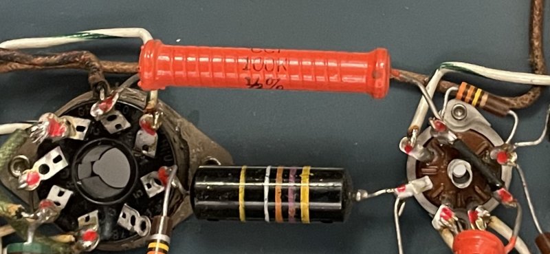

Cool amps and certainly not easy to find, I'm sure. I'm not sure if some of the info you found on this is accurate, though.
As far as I know there were no parts back then (resistors and caps) that had a 0.5% tolerance. The tightest tolerance on those carbon comp resistors was 5% and it looks like that's what you have in the pic if the 4th color band is gold. Silver would be 10% and no band is 20%.
It's entirely possible, however, that the individual parts were all measured and that they hand picked parts that were within 0.5% of the correct value.
Carbon comps are not particularly stable. Their values tend to drift higher due to age, humidity and heat. Even if they still measure in spec they can be noisy.
The can caps are electrolytics, not paper. I forget if the Bumblebee caps are paper or mylar construction but, as mentioned, they are almost always leaky (electrically) and should definitely be replaced.
As mentioned, Hayseed will stuff cans with whatever values you like and they use high quality caps but they're not cheap. I would avoid any other replacement cans even if you happen to find some that are the correct values.
You could also just disconnect the cans, leave them in place for looks and mount individual caps underneath. That will be much cheaper. I try to use caps that are rated for 8,000 to 10,000 hours at 105 degrees. Their other specs tend to be excellent too. But most any modern cap should be higher quality than the originals. Use name brand caps only (Nichicon, Panasonic, United Chemi-Con, etc) sourced from a major supplier like Mouser or Digi-Key. That's the best way to avoid counterfeits. Digi-Key has a free shipping option:

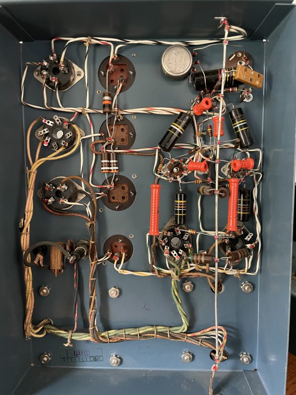

I looked at the schematic and, at first glance, the use of an 80uf first cap after the 5Y3GT rectifier looks too high. The 5Y3 data sheet says maximum is only 20uf. However, since these are mono amps the current draw is much less than if the 5Y3 was supplying both channels.
There are 3 charts for cap input on the data sheet and the amp must pass all three of these tests. A quick look at them based on the what's in the schematic suggests that 80uf might be OK. You should go through the graphs more carefully, however, to confirm that.

If you're planning to use then, the bumblebees will need to retire, and I support the idea to change the electrolytic cans too.
Getting some good quality radial capacitors under the chassis on terminal strips should be well within your Dad's skill set
I'd leave the resistors alone unless one is noisy or else if the phase inverter is badly unbalanced.

You are right on the money about the carbon comps and the bumblebees, all 5% parts. But the orange wire wound resistors are indeed stamped with 1/2%. I was shocked when I saw that.

Yeah, wirewounds are different and apparently much easier to manufacture to close tolerances. Unless they've been overheated by some catastrophic event they don't need to be replaced.
Perhaps others will comment, but I'm not so sure "black beauties" are any more reliable than the bumblebees.

There's plenty of room underneath to acommodate individual caps leaving the cans in place.
I will suggest grounding replacement caps to the same chassis or buss locations as the caps they replace.
There is a pair of 2w 390 Ω resistors in parallel which could probably be replaced by a single 4-5w 195 Ω metal oxide resistor

Though I may be flamed for Mickey Mouse behavior by some, I decided to recap the power supply underneath the chassis. That way I could retain the original Aluminum can caps for looks up top, and it also proved impossible to find suitable replacements from the vendors for any kind of reasonable price, and since some of the phenolic washers on the caps had been snapped prior to when I got the amps, I would need to refasten the replacements with screws, much as I’d like to be able to rivet the replacements. Using those screws, my dad and I built some new power supply eyelet boards with garolite, and used standoffs to secure it beneath the original can caps. I used Sprague Atoms for the power supply, and Kiwame carbon film resistors to replace the original carbon comps. I also was able to wire the replacement cathode bypass caps directly to the ground bus from the power tube sockets by not using the original can cap location.
Once the power supply was done, I changed out the .047 coupling caps in both amps. This was necessitated by one amp came to me with some suspect no-name replacements for the original bumblebees, and I want the two amps to match, parts-wise. Since Jupiter makes reproduction Bumblebees in that value, I put a couple of those in each amp. At this point, I checked for shorts and checked the ESR on the remaining 3 Bumblebees in each amp, and finding them to be all right, powered up each amp slowly with a variac, and checked voltages. Everything looked good, and when I put some music through them, music came out the other end!
