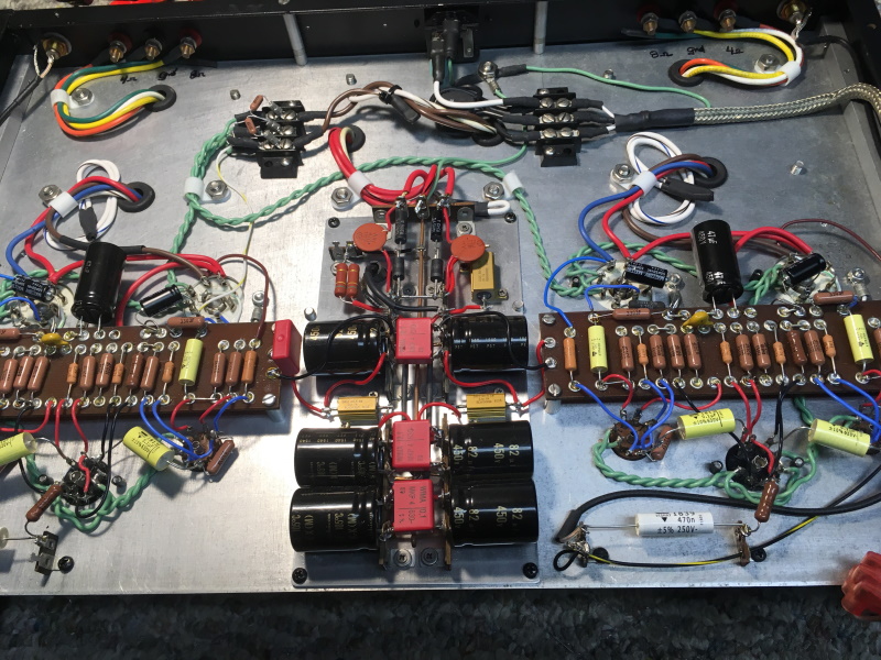

If you have the gear to do so, confirm the frequency response if you use a resistor to eliminate the pot and set the sensitivity. If there is too much treble roll-off, experiment with small value caps across the resistor to restore the response.
Those brown epoxy caps may have been original. Those are mylar caps, ElMenco branded in this case but I think they were made by Cornell-Dublier. Perfectly decent cap honestly, and they last just about forever. I ran a set through a dishwasher once just to see what would happen. Besides most of the print being gone, they still work perfectly fine.
Thanks for the input Gadget!
That’s an interesting observation about the vintage of those caps. I don’t think they were original in this case, as they lacked the red paint pen QC marks on the solder joints that are elsewhere, but good to know they are pretty reliable in case I encounter them again in other gear.
Regarding the frequency response, I have not attempted measuring out an amp, ever. I have an oscilloscope and a function generator, but know nothing else about the proper measurement process. I’m sure it’s covered somewhere on here, I’ll poke around. Electrically, can you shed some light on what happens with the removal of the pot that necessitates another cap? My basic thinking was that it’s just a variable resistor, and could be swapped for the proper fixed value, but I’m assuming there is another property that needs consideration of which I am unaware, but eager to learn.
Possibly not original, but still probably quite old. I've got some in early 1960s gear.
Usual easy way of checking response without getting too nuts about it is to just do a square wave test, probably at 1khz. Can actually do this while the pot is still in, set the function generator so you get about 1 volt peak to peak on the output with the pot all the way up and note what it looks like. Drop the input sensitivity and wind up the generator to get the same sort of output. Fair bet you'll notice the leading edge of the square wave start to round over as the pot is turned down. Theoretical ideal is with the leading edge as square as it gets, without overshoot or a lot of rounding at the top. Overshoot would be a rising HF response, rounding would be a falling HF response. Square is flat response.
basically what you've got going on here is a simple RC low pass filter. The R is the pot, and the greater the amount of resistance between the input and the tube grid, the lower the frequency of the filter. The C is the effective capacitance of the tube * the tube gain. This is whats called the Miller capacitance. A 12AU7 doesn't have a ton of gain so it won't be extreme, and it may not be enough to care about but its just something to consider if you've got the ability to measure for it. Looks like it may already be compensated for with that RC network across the cathode resistor anyway. That will provide a bit of HF boost.

Got my amps fully dialed in now. I finally got in and ditched the 3 remaining bumblebee coupling and input caps, and swapped in Jupiter copper and wax replacements. Took care of the small hum issues the amps had immediately, and definitely opened up the sound a bit more.
These amps sound so so so good. It’s a little wild they aren’t talked about more, I’m truly blown away in comparison to everything else I’ve ever heard or owned, and that list runs the gamut. Midrange and transparency like a SET, bass control and snap like something Ultralinear.
They are especially lovely with a 601C/614 speaker build I just finished, though I’m still waiting on better crossovers to show up. Jagusch, predictably. I took the amps, speakers, and passive line stage to a local diy audio meetup here in Brooklyn, and people seemed to agree with what I was hearing, even in a casual ad hoc setup.
I’m still considering axing the input sensitivity pot, as I really can’t come up with a use case where that would be particularly helpful, and I’d have to assume a fixed value resistor would be more transparent in the signal path. Other than that, I just need matching power cords, and a new power switch in one amp to replace its current one that likes to stay on sometimes even once flipped to the off position (a fun trick..). Then these puppies are fully done, as far as I’m concerned.
