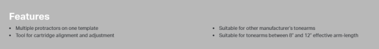

the protractor says "for 9" tonearms"
the YA-39 is longer than that. Does that matter?
Got brush for records and stylus, and the balance, already.
OK, so ya it's a bit over 10.3", not really sure on that, it's worked on all of the arms I've had here so someone else will have to chime in on that.
I have two others here but they're both Baerwald like the Ortofon except one is also Stevenson on the other side. I don't remember them mentioning arm length.
The middle protractor is flipped over to show the Stevenson side, the mirrored protractor helps with a rough azimuth setting.
effective length is slightly above 10" (26,2 cm)
Ok, did some research and apparently this will work with any arm but it's not cheap.
Nix that, here you go, works on arms from 8" - 12" for a LOT less money.
gotta get back the R&D that went into that thing knowing they will only sell a couple dozen :D
I'll try with the ortofon and see what I get.
combines the three typical types..
I guess, this would be the best one:
that's the "Align it DS3" and it would be perfect, really!
at 80€ I'm honestly just going to try my luck with the Ortofon protractor at a LOT less...
