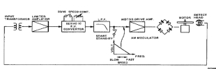

The head picks up an AC signal prerecorded onto the inner platter rim surface, its then integrated to a DC voltage level of strength related to platter rotation rate and amplified to drive an AC passive platter motor throttle consisting of a Graetz diode bridge in series with the AC platter spindle motor, the bridge having power transistor across the points where dc output would normally appear. This throttle arrangement allows a DC only power gain device to control AC voltage level to the motor.

Denon DP-1200 service manual is here:
Block diagram:
It is eactly the same strategy as the early Sony direct drive turntables.
The "motor drive amp" has as critical part the transistor that is on the heat sink. As i mentioned, if it receives no signal or full signal, the speed will get crazy (or stop).
If the Low pass filter (LPF) is not working right, the speed will not get stable, it will "hunt" around the correct speed.
The service manual has a full explanation of how the circuit works, because Denon engineers are nice people.
Tr4 is the critical part i was alluding.
