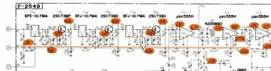

Tested Emitter of TR01 on F2431 and it was good at 12.65 Vdc. Schematic shows the 12.6 Vdc leaving F2431 at post 01 and going to "B11/Post18 on F2549, where I found 0 Vdc.
So I traced the red wire coming from the Em of TR01 on F2431 and instead of going to B11/post 18 as on the schematic, it goes to an unmarked post next to the screw on the corner of F2549. See photo below. Traces connect the post to points 1 (jumper wire to unmarked connection on the board just past the middle screw) and 2 (jumper wire).
Bottom line this F2549 is NOT the same board as the schematic or diagram. Second photo, of the board diagram, shows a connection from the post the red wire from F2431 is connected to jumped to "B11"/Post 18. Connection to post 18 is not there on my board.
Are there different versions of F2549, and are there corresponding schematics/board diagrams?
Now I'm finding the 12.7 Vdc one pin to the right of the pin #18 on the diagram, #19 printed on the diagram. So doesn't match the schematic.

Back up a bit from the front end pack. The 12 volts you are looking for comes from the F-2549 pin 03 (point Y).
I'm pretty sure the yellow wire is not the one you are looking for.
If you don't have that 12 volts on pin 03 then the power for the whole FM IF strip is in question.
There are several resistors on that 12 volt line that could be open if the 12 volts at pin 03 is missing.

So there's about 100mVdc on your choice of the three posts w,x and y. Went back to R33 and there's good juice there. Working toward the posts.
Resistors in line are getting voltage going downstream towards the w, x, z posts until R17, which is empty, no resistor or jumper. Can it be as simple as putting a 4.7 ohm .25 watt resistor in at R17?
That is really really strange. Do you know if it ever worked? Does it look like the trace side of the circuit board has been worked on around R17?
Yes it could be that simple if somebody has been in there before you. X and Y will be the only ones with voltage, W is the IF signal from the tuner pack.
Dosen't look messed with. The holes are capped with what looks like original solder as though it's been that way from the factory.

W = 40mV
X = 12.2V
Y = 3.15V
Went back and measured again because it looks from the schematic like X (#2) and Y (#3) have their voltages crossed. 12V on one side of R09 and 3Vs on the side next to X, but I get 12V at X (middle post, #2).
Y (#3) shows 12V on the schematic at post Y on F2549 and on F1519, but on board F2549 Y tests the 3V the schematic shows on X (#2).
Wonder if this is why they left R17 out, and they had the correct voltages via another path before a part crapped out screwing up the works.

You have a voltage divider with R8 and R9. With twelve volts in you will get 3 volts out, supposedly at pin 2, going to X on the tuner pack. That is the AGC voltage
Pin 3 of course should have the full twelve volts going to Y on the tuner pack.

The 12V gets knocked down by R09/100K on the way to post 2 (X), but if you look at the board diagram it looks like R09 is connected to post 3 (Y) which would explain why I'm getting 12V on post 2 (X) instead of 3V. Also nothing between R17 and post 2 (X) means it would get the whole 12 V I'm seeing.
Went and tested and R09 is connect to post #3 (Y), also in circuit it measures 25K. R17 mainlines into post 2 (X) and that's why we're getting 12V at post 2 (X).
Also, when I tested this time I gave it a little more juice and we are getting week sound from FM.
Edit: Would the weak sound be a bad transistor/s not amping the signal?
I changed the schematic (R09 & R08) to show what's actually happening on the board. It matches the board diagram, R09 is actually cutting the V to post 3 (Y) instead of post 2.
Added the board diagram which is accurate it for posts 2 and 3 with reference to R08 and R09, and voltage.

Good catch on the board. You can certainly see what is going on with the traces.
