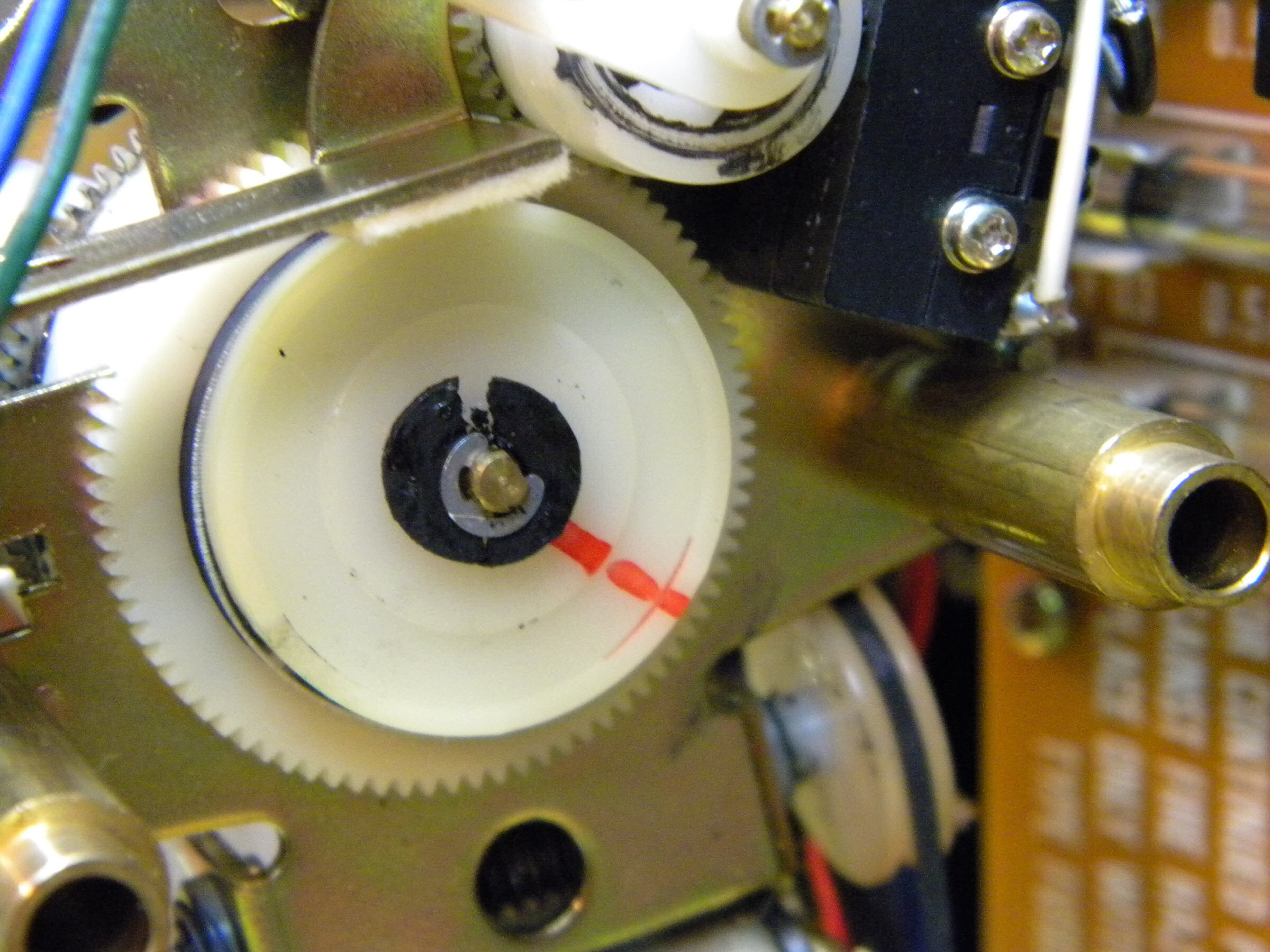

But here's a problem...
Two microswitches that sense whether the arm is up or down. Ok, they work, when the red cam spins, they hit a detent and go from open (pin on the switch depressed) to NC (normally closed with the little pin on the switch released). Infinite resistance when open but one of the two switches really varies for resistance when closed. 3 ohms to several hundred. Probably dirt or corrosion inside. I tried re-soldering in case it was a cold joint (no luck), tried contact cleaner (no luck, I don't think the spray can really get in the switch). It's an Omron switch and it looks like maybe they still sell at least this size.
Anybody know if they are available and which one will work? The D2MFS code gets close but no cigar and the 3A250V AC seems like a vast overall. Approx dimensions are 18mmx9mmx6mm so it is pretty close or the same as their type S basic switch.
Lordy, I love when things work out! Check this out, the Omron switch can be [carefully...] disassembled and cleaned!
Pop off the top at the green arrows, don't lose the little pushbutton and be really careful with the copper spring/armature. My ohmmeter indicated most of the unwanted resistance in the switch was at the contact but it looks like the other end of the spring is also just friction contact. Electrosolve Contact Cleaner helped a little but really, best was to scratch both contact surfaces with a really, really tiny screwdriver and/or my dental pick. If you don't have a dental pick, spend some dollars on a good one or make an offer your dentist can't refuse.
All set, resistance is now less than 1 ohm closed (button out) and inf when open (button depressed). Sorry I may have had it wrong above...

I was lucky to find a replacement rubber washer about the same size in the bin:
It was just a little bit thinner, but:
Service manual lists it as one of two damping washers. I think that is engineering speak for, "The prototypes are making a horrible metal-on-metal 'clank' when it switched from from "raise the tonearm" to "swing the tonearm. You gotta fix that Mr. Engineer!" "OK, Mr. Manager, I'll add a 0.5 cent rubber damper washer."
So, probably not too critical to the function. It might even function without it.
