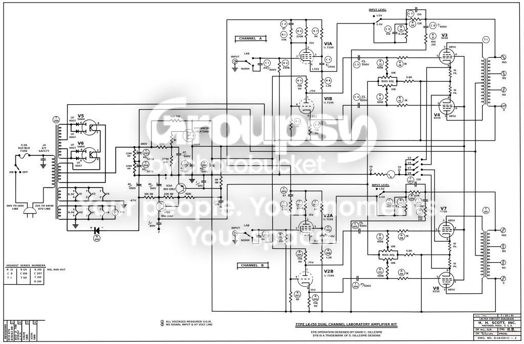

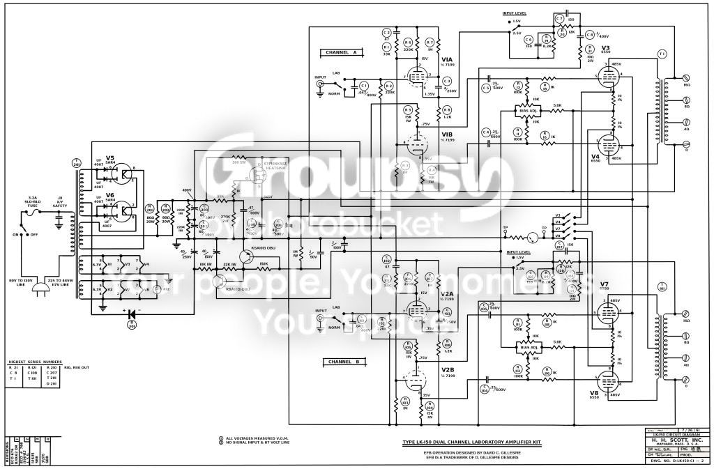

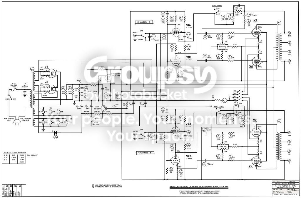

I think this should have everything fixed. Re-drew a couple of connections for clarity, removed a duplicated capacitor, and fixed the MOSFET. It was drawn in backwards in the early versions.
Not many great ways to do that without punching holes in the chassis for more sockets.
Also, I happen to have a nice supply of 7199s, 6U8As and 6GH8As around. :)

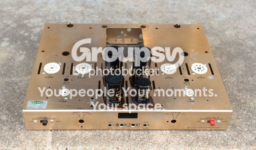

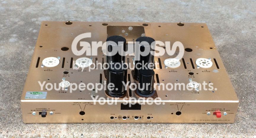

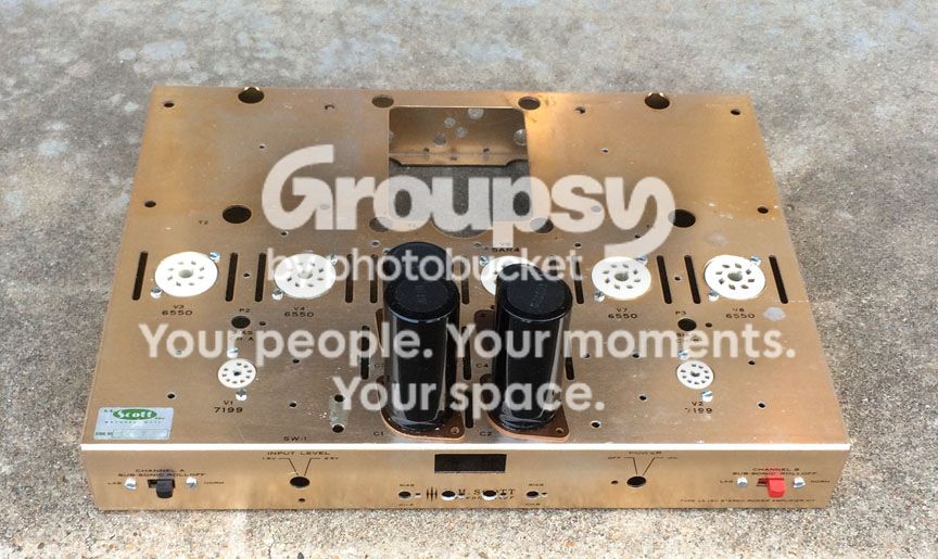

Got the chassis completely stripped and scrubbed, opened up the octal socket holes a bit more for mil-spec ceramic sockets from the 1950s (not the most perfect job, admittedly, but they'd already been messed with in the past), and got the new ceramic octal and nine-pin sockets installed, along with the front-panel slider switches. Still need to drill holes on the top for the new bias pots and open up the terminal strip holes for the new collection of binding posts.
Still deciding exactly how to orient the caps. Soliciting opinions for both cosmetic and functional purposes.
Option 1:
Option 2:
Option 3:
Kinda leaning towards #1. #2 would give the 5AR4s a bit more ventilation room. I'm not too keen on turning the capacitor lettering outward. Option #4, not pictured, would be a combination of #2 and #3.

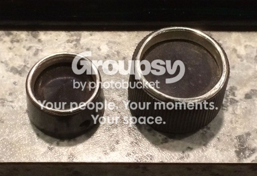

Considering that I only have one of the original knobs, and Scott only used that particular, large knob on the LK-150, I'm thinking about replacing the original rotary power switch with something like one of these:

Put up a picture of the Knob you have I might have a match on hand.

What brand are those filter cans? I think that gold screen print looks great in option 3
Angela Instruments, glued to some NOS fiber twist-lock bases that I picked up on eBay (the little can has an extra fiber washer under it so that it would actually cover the holes in the base). Battradio turned me on to them after one of my Fisher 70s blew a cheap filter can from AES at one of Sheltie Dave's gatherings, when it had maybe 20 hours of run time on it. As long as I can get away with two-section cans, they're pretty much my go-to now. The performance is very good, and the price is unbeatable.
http://www.angela.com/electrolyticcapacitors.aspx
The two big ones are a 100uf/100uf 500V and a 50uf/50uF 500V, the smaller two are a 32uF/32uF 500V and an 8uF/8uF 500V that will be paralleled to make the two 40uF caps for the bias side of the power supply.

This is going to have individual output tube bias as well. I borrowed that section of the schematic from the Citation II, with some values tweaked to bring the resistances back around to what Scott specified in their rather more complex setup.
Here is the knob, on the right, next to a standard Scott LK-series knob:
As far as I can tell, the only thing they used it on was the LK-150, and it wasn't an off-the-shelf part from a supplier. It's bigger than the "standard" knob, both in diameter and thickness, the sides are straighter and fluted, and the center is flat instead of cone-shaped.

Actually they used both those styles during the production of the LK-150. But with both styles they were always that large. I personally think the amps look better with a smaller all gold anodized aluminum knobs like the earlier power amplifier came with. I have some of those also. I'll have to dig through my stash and see if I have one to match the style you have. Give me a few days I'm buried with work around here. If I have one its yours for the cost of priority small box flat rate. If you don't hear from me by the end of next week rattle my cage via PM.
The LK-150s I've seen for sale have all had the fluted knobs.
Just looked at the back of both knobs - made in Japan. Huh. Would not have guessed that.
