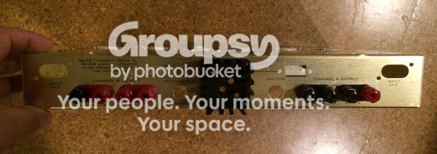

Back panel, with the slots opened up at the ends to properly site the binding post pairs. The heat sink for the regulator MOSFET is just sitting there for now. The holes that were already drilled for the TO-3 socket when I got the amp are what started this project down the rabbit hole of modified power supplies with solid-state regulation.
I'm going to cut some spacers to fit between the pairs of binding posts, both to close the hole and to help locate the binding posts. The holes for the accessory sockets are going to be blocked off.

I would have made some more progress last night, but it turns out when I bought the momentary switches for the bias metering, I picked up "normal closed" instead of "normal open." D'oh! Back to Radio Shack sometime today. I can't find my big box of grommets, either, so I'll have to stop by ACE and get four grommets for 5/8" holes. As it is, I got the bias pots drilled and mounted, and bolted the T03 heatsink on the back. And, just for cleanliness, I used some acetone and cleaned off the mostly-obliterated lettering that would stick out from under the heat sink. And the second "0" from under the old speaker terminal strips.

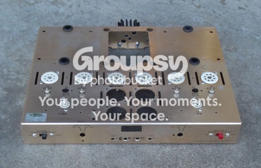

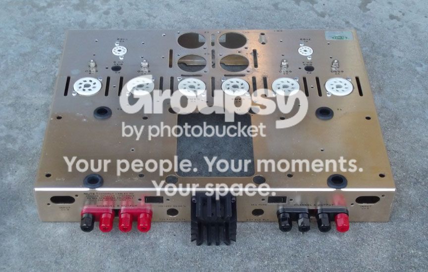

Chassis progress.
Now I just need to look over the transformers and decide if they really need new paint, or if I just want to polish up what's there and live with a bit of flaking. It's not like this is going to win any cosmetic awards, though it's not as deliberately ugly as the Fisher 70s.
One thing that I can't figure out are the holes under the OPTs. They each had a star washer riveted into them. Nothing else, just a star washer.
