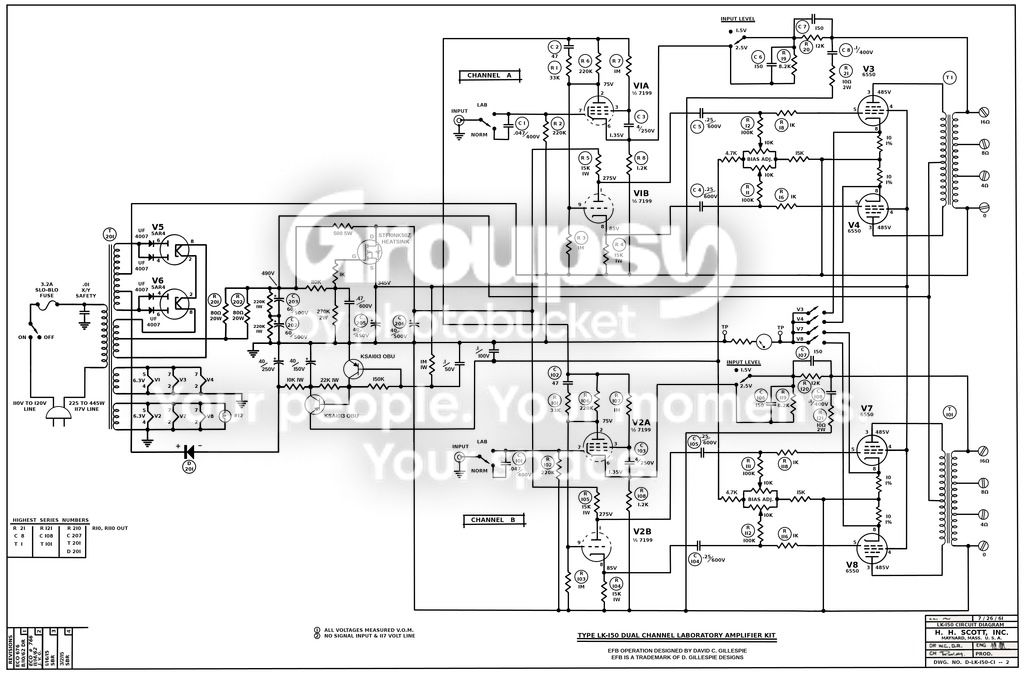

It has been pointed out to me that due to the corrupted condition of the Nov. 62 schematic I started with, that there was a numbering error in the 7199 pins.
Revised schematics attached.
Edit: some voltage errors were brought to my attention, schematic is now revised again:

I stole the independent bias circuit from Stu Hegeman's H/K Citation II, with some tweaks to keep the overall resistance in line with the original LK-150 design.
Thanks for the revised schematic. Interested to see how this project looks and sounds when finished.
Revised schematic. dcgillespie recommended a tweak to the power supply in a recent message.
I've started working on the physical placement of components, taking the modifications into consideration. Last thing I need to do is whip up a little DC power supply to take the place of the pilot light. The digital meter can take a wide range of input voltage, but it needs at least 4.5V to work.
