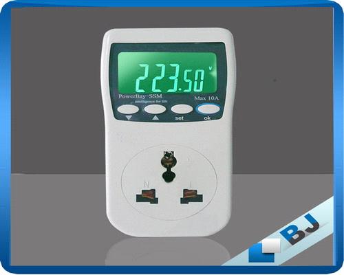

if you set with dim bulb tester you will need to reset with it plugged in directly .
turn it down in-between as it will rise the current when plugged in directly .
try first with bulb tester .
4.2mv looks like it will be safe .
you could maybe get one of these afterwards to final check it.make sure it will do the job as there are different ones with different features
