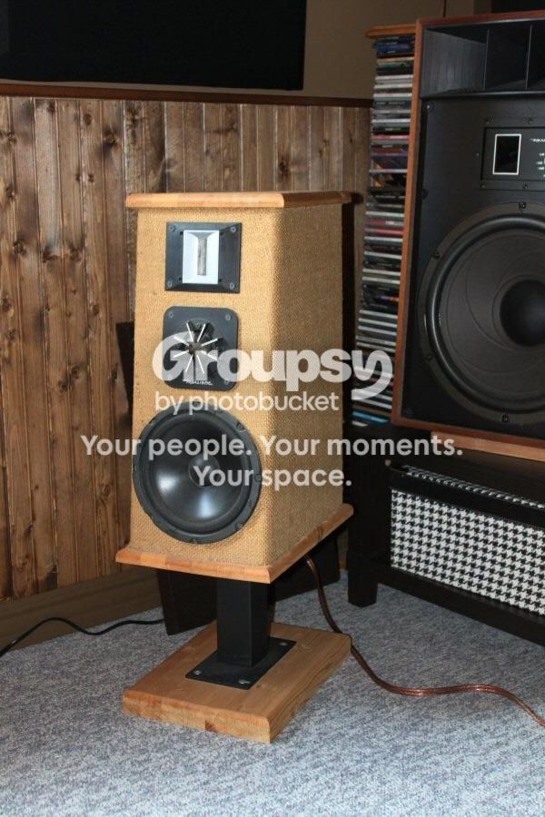

This thread prompted me to drag out a pair I built about 15 years ago, that have been carefully stashed in a closet for about 5 years. They were thrown together with some RS components that I had laying around. The tops and bottoms are double laminated pine project boards but the boxes are MDF, braced, screwed and glued at every seam and they are rock solid. The base posts are integral, made out of aluminum railing post and plates, painted flat black. I wrapped them in burlap mostly out of convenience and never really finished the wood. It's developing a "dry" patina.
The tweeters are the RS 40-1375 Leaf Tweeters and the mids are RS 40-1281 soft domes (fabric). The 8" woofer....well I can't remember for the life of me but it's got good excursion and reaches fairly low. I believe they're crossed over at 1200 and 5000.
These are not high quality drivers but they have a very engaging sound and I've fallen in love with them again. Backed up with a good sub, they are richly detailed with a three dimensional sound field I haven't heard in a long time. The dispersion is excellent. With your face right in front of the right speaker, you can clearly hear the mid and high end of the left speaker, 10 feet away. They bring out interesting nuances in music that I've never heard before. The higher attack of a string bass in a Chris Deburgh tune that I didn't know was even in the song, or the softly decaying rattle of the snare springs in "One Headlight". And they don't seem to have any of that undefinable fatiguing rasp that many other lesser speakers have (including the Mach 1's in the background - they're awesomely loud - good for when you're in a mood but not for relaxed listening enjoyment).
They may not have the beauty that many of the projects displayed here have but I'm happy with them!
