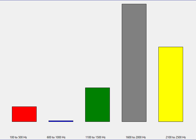

I found an interesting article here. The author has recorded the spectrum of various musical instruments, and he found trumpet has very strong harmonics between 1.6 kHz to 2 kHz, as shown on the picture above (not mine, it's his).
Trumpet has very strong harmonics from 1600 Hz to 2000 Hz, as shown by the grey bar. The said harmonics is even stronger than its fundamental frequencies.

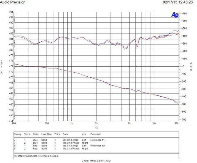

On the other hand, the original NHT SuperZero (the A450 and the XU; the latter is what I own) has very strong peak at 2000 Hz. Is that the reason why trumpet, despite having such clean and fluid sound, sounds very harsh on my SuperZero XU?
The original NHT SuperZero (the A450 and the XU) has peak at 2000 Hz; is that what makes trumpet sound harsh?

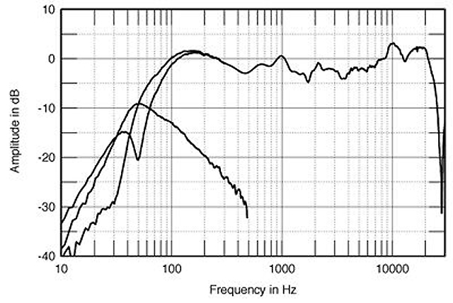

It is interesting to note that trumpet also sounds harsh on B&W DM302, though not as severe as it is on SuperZero. Perhaps because DM302 has second (and slightly higher) peak at 1000 Hz, that makes the entire sound warmer?
Bowers & Wilkins DM302 is also peaked at 2000 Hz, but it has higher peak at 1000 Hz. Perhaps it's what makes the trumpet sound (slightly) less harsh.
What if I use NHT SuperZero 2.1, which is voiced differently than the original NHT SuperZero? Instead of peak at 2 kHz, the SuperZero 2.1 actually has dip at 2 kHz, which may make trumpet sounds less harsh. Also, the curve keeps rising from 9 kHz, up to 20 kHz and perhaps even above it! Does it mean that cymbals and hi-hats will sound airier on the SuperZero 2.1 than on the original? Because airy cymbals and hi-hats is exactly what I'm looking for; it is the reason why it's hard for me to part with JBL titanium dome tweeters.
NHT SuperZero 2.1 has dip at 2000 Hz; will it make trumpet sound less harsh? And will cymbals and hi-hats sound airier on the 2.1?
