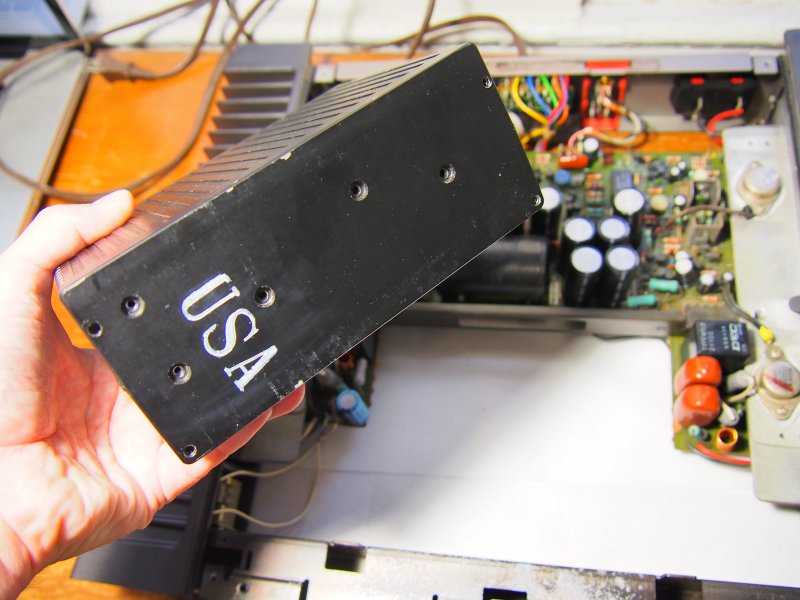

The other end of the diecast case is closed. Actually it is one piece on the other five sides. However, the other end has 5 holes for the 5 screws holding the PCB in place. Those are the 5 screws in the lower picture on Page 8. Though I unscrewed them, the PCB did not become loose, it is still firmly in place. No idea what holds it in place now.

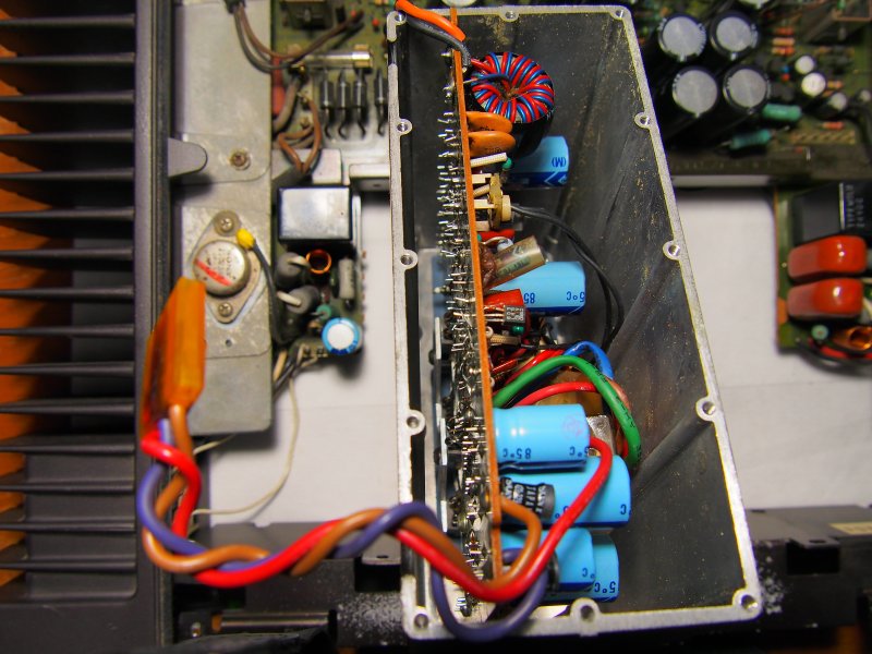

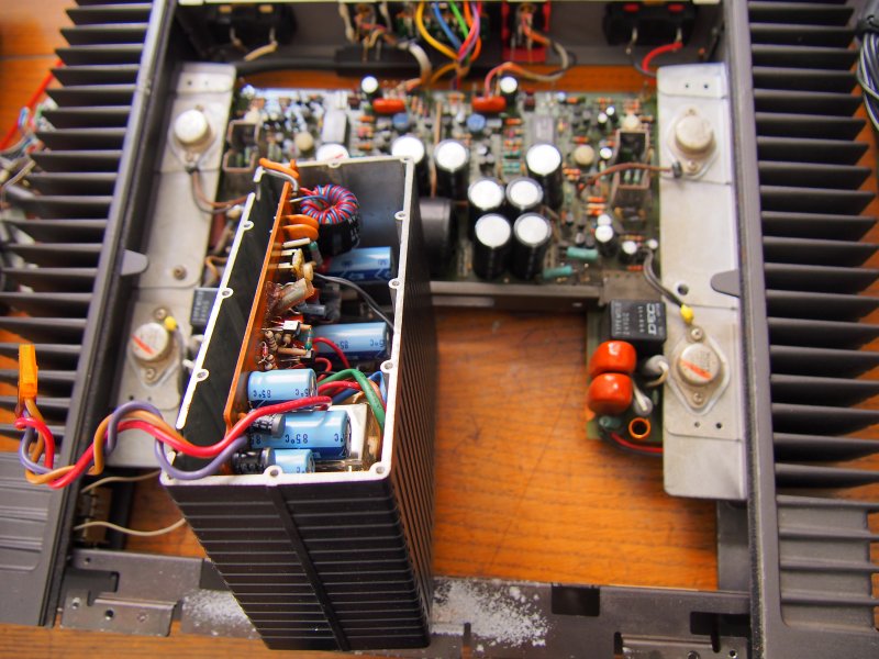

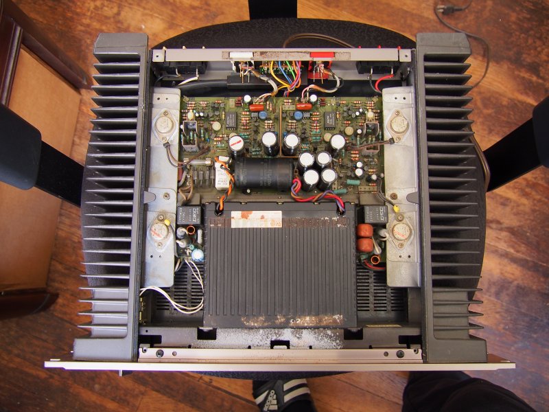

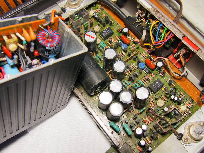

A few more photos of the PLPS case. The back with the 5 removed screws that supposedly hold the PCB in place. Two photos of the inside of the PLPS unit. Apparently, there is a blueish sheet at the bottom, which might be the insulator. And another photo of the other parts, caps, etc. on the main board.

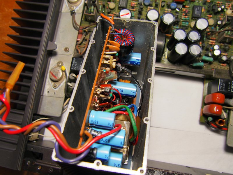

I was using @Goldie99 's method and after several trials, first very gentle, then gentle, then even more force, eventually some (gentle) hammering on the bolt that I partially screwed back in as he suggested, I got the PCB out. A few photos of what's inside the box:
It doesn't look terribly bad. What do you think?
What is not so good, however, is the what you can see in the last photo's lower right corner: one of the ceramic cement resistors broke into two. Not sure when it actually happened, but now the TA-N86 won't even turn on.

The broken resistor in your last photo seems to be R401, on the completely separate main power amp board - if so, then it's part of the mains voltage rectification of the power supply going to the PLPS circuits, and (if you're lucky) may well be the reason why the unit no longer powers on. It will obviously need replacing.

I assume the big 820uF, 200V Nichicon reservoir capacitor needs to be replaced along with a few other ones.
if you went to so much trouble to take this apart, I would replace all lytics on that board.

Heatwise, I noticed while the amp was open, and I was using it in class B mode that the right power FETs were very hot, while the left ones were just warm, not hot at all. Weird. I noticed this only after I started playing with setting the 90 V right (it was 94 V before I opened the amp) and the bias currents. I more or less managed to get the 20 and 350 mA's for class B and A, respectively. The PLPS also heated up after a while.
