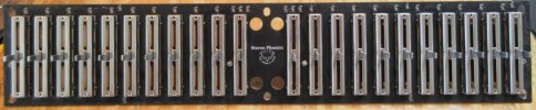

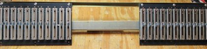

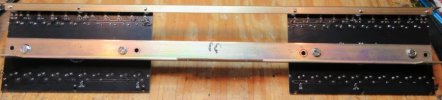

The AE2000 boards line up with the holes and slider openings, but there are a few issues. The first I noticed, was the two terminals located highers up, are blocked by the bracket. The next thing is once the boards are moved forward, they hit the face-plate mounting brackets. The third issue being that I only ordered left boards. I still had to order the right side. The parts positions are mirror image, but not the terminals. So I made the corrections and ordered new boards. I may also be able to move them forward by reversing the top bracket for the boards, and not use spacers there. It will depend on the final fit of the knobs and clearance to the LED board.

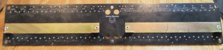

The new boards are cut right at the edge of the outer sliders. This is to fit the brackets and also except the wider slider. It is as close as it can get in there.
The board is now cut to the edge of the slider to fit, only on the outside slider. Which is also the comparater balance slider on each board. And is why that slider has 3 terminals.

The original AE2000 boards were the same for each side. They just used jumper wires to choose which one was going to be the comparator or the tone control. i didn't have that option because the new sliders don't have pins to wire-wrap to. So instead of using jumpers and having extra pins for each end slider, it seemed less confusing just to make them left/right. Especially if I sell some of these for DIY projects.

New left and right AE2000 boards, cut right to the slider edge on the outside. Hopefully it fits without cutting the bracket.

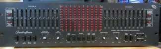

I double checked everything and found some wires in the wrong position. Then tested, and found the 15Khz display would not light. I traced it back to a bandpass filter opamp IC. It was outputting -14VDC. Replaced it, and good to go. I adjusted the lights and gain pots and tested. Then put the knobs on. They actually fit fine with a little force to get them on. Nice and snug. Also repainted the cover.

I'm hoping a new slider board will fix the issue I have with my SP4002: With each slider set exactly the same on each side (A & B), the stereo image is not centered. It's as if the balance control is at 10 o'clock. I end up with the Channel A zero gain control down below center, and the Channel B zero gain control up above center.
Attaching a photo that illustrates the scenario...
Forgot to mention that both PE2217-Rs that I own have the same issue, each to a differing extent.
