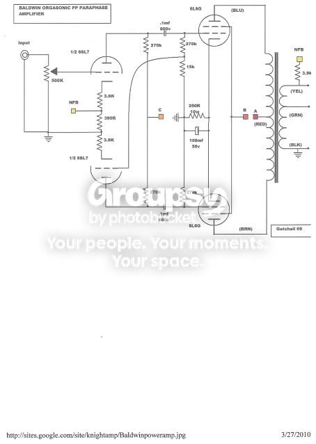

Haah, thats the schematic I drew up from my Baldwin Org-O-sonic amplifier. Let me know how it sounds, I haven't finished wiring it up yet.
You schematic is easer to read than the 45pb so hope you don't mind that i linked to it .
I realy like the circuit quite a bit ,
