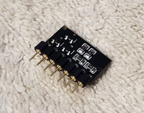

Here are the BA312 replacements assembled and ready to install.
I started work on the pre-amp board last evening and got about half-way through. Not sure what it means but the board has multi-color coded caps in place of the "Blue Blobs" that are normally on these boards. Today I will finish replacing the caps, replace the four transistors and replace the BA312's. There are many threads in the Marantz forum about sizzles, crackling and other forms of distortion that end up being caused by failure of components on this board. Replacing the possible offenders seems prudent given this history while I have it out and on the bench.

The Ba312 replacement boards were a gift from an AK'r. I hesitate to provide contact info as I do not want to presume to do so. I have also used this replacement:
Which I got on the bay. Just search for BA312 in the bay and you will find it. They are $18 each plus shipping. I generally just replace the BA312's weather they are good or bad when I restore the Tone board for sake of completeness as the kit of parts replaces all of the other transistors on the board and the Ba312 can cause issues going forward. This unit installed easily and worked well.
