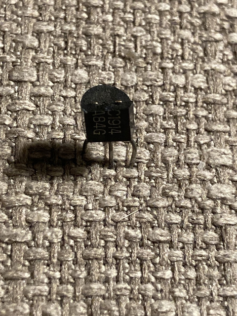

Transistors Main Board:
They should all be ECB except for the metal backed. Those are BCE, refer to pictures if you have them.
All ECB Transistors have the Emitter on the far left side writing facing you. C middle, B Right.
Obviously its reversed for BCE. And the board is marked where the Emitter goes anyway.
Replace (4) C1775 & (2) C945 with KSC1845
Replace A904 & A850 with KSA1013 (these go in opposite of the 904's 850's assuming they are still stock)
Replace C1914 with KSC2383 (verify pinouts)
Replace C1904's with KSC3503 (verify pinouts)
Replace C1384 & C1885 with KSC2690
Replace C1913 with KSC2073
Replace A913 with KSA940
Replace D712 with KSC2073
Replace B536 with KSA940
Replace D325 with KSC2073
Leave the KFETS alone
