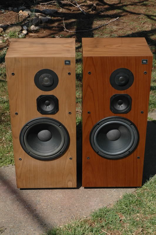

So I've had several pairs, 4312's, 4313b's, 4311's, etc. and I've always loved that nice finish they all have. Here's the thing. I just got a pair of 4311's. Cabinets are in good shape but they are really dark looking. I don't want to strip the finish off. I'm hoping there is some way to CLEAN these and bring them back to that light looking appearance that they once had. A search shows your basic stripping back to nothing approach, but these don't need that.
Any ideas?

Very light sanding to take off 30-40 years of ???? might also help. I would opt for (natural) Watco Danish Oil finish with just a touch of red stain to get a little bit of color out of them.
The OP thinks the cabinets are darker than they should be and thinks cleaning them will somehow lighten the color. Ain't going to happen as that is the color they came in. The only way to lighten the color is to strip the finish, which will remove some, perhaps most of the color. If after stripping they aren't light enough Clorox bleach will remove even more color.

Yeah, I'm basing it on my memory of some other pairs of 4312's I had that came out of a radio station. They had never seen sunlight. Ever. Those were a shade or lighter then what these 4311's are. Found a pic of them so below is a comparison.

Agreeing that's probably the color they were born with.

I'm doing a test on the bottom of one. Using a spray called "Scott's Liquid Gold Wood Wash" and some super fine steel wool. Removing crud that looks almost black at first. After three cleanings the wood does appear to have more grain detail and is a slightly lighter shade. Looks like lots of work though to do the whole speaker!
I had a very dirty pair of JBLs once, cleaned them with a Mr. Clean Magic Eraser and water, following with a terrycloth towel quickly / as I worked to keep the moisture from getting too deep, ... seemed to work well (even removed sharpie on the wood). Too much moisture will eventually raise the grain and need fine-sanding to get that perfect flat-smooth feel.

I have used both mineral spirits and Formbys Furniture Cleaner to successfully remove darkening due to years of wax and dirt build up. But at some point the stain color is what it is.
Formby cleaner seems to dissolve a bit of the finish as well...which gets re-deposited into scratches, etc, helping to hide them. For small damage, very light sanding with 180/220 beforehand seems to work nicely.
Howards Restor-a-Finish will be notably shinier than the original oil finish. Watco oil will be much closer to original.

Besides sanding I have found using Purple Power degreaser to be an effecting way of de-ageing darkened cabinets or removing light stains. You must be careful when using it, it is very aggressive and WILL strip the finish completely off if left on or worked into the surface for too long.
I would recommend following JBL's Oiled Finishes maintenance instructions afterwards.
