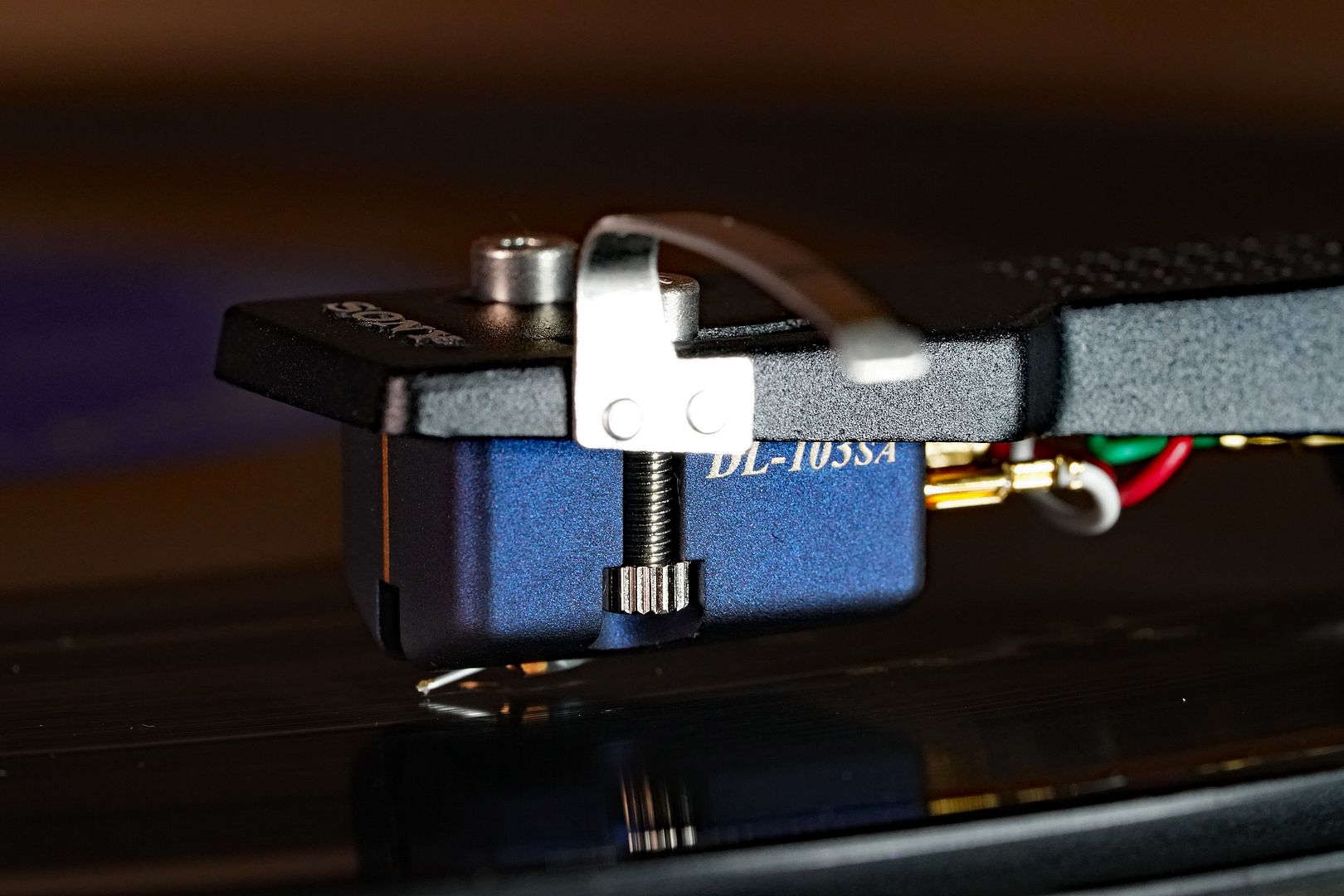

Hi, I did this for the guys at L/H, but it is equally as viable here. Arm suitable for the 103 range (apart from 103D/S/M) so 90%.
1st graph is on a 12 gram arm, defiantly not suitable. Arms need to add a lot of mass.
2nd graph a 25 gram arm, OK & most people would be happy. But more can be achieved.
3rd a 35 gram arm, this is where you find out that the 103 really has bass slam & depth & the midrange opens up to near, but not quite to Koetsu level.
So I guess around 95% of users are missing out on a lot of what the Denon can offer & is this one reason why Stereophile Recommended Components mag lists the

thank you for posting this! Just a quick follow up: why did you mention the DL103R? As far as I have understood, compliance is the same as the stock DL103, the difference being fewer windings on the (then lighter) coil and different coil material. Would that exclude the R version from your calculations?
Yes, No prob's Fidelity Research FR-64 S & Temaad Merlin-35 (via special order, see website) & some of the Ikeda arms
This is what a review on V/E say's about the 64s, all reviews were 5-star
''This arm has the same high quality build and attention to detail as other FR arms I've used. What sets it apart is it's high mass which makes it ideal for use with low compliance carts such as the Ortofon SPU, Fidelity Research FR7 or Denon DL103 standard. There are few other arms can get the best from these carts''
