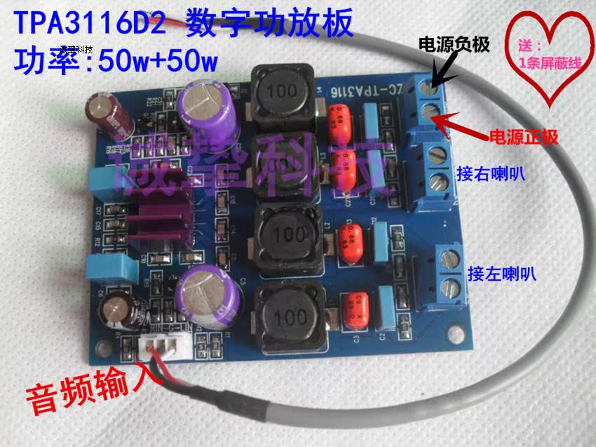

Wonder if anyone already purchased something on Panlishop.com?
I came across this service/shop while was searching for the 'real blue' board - Cheng Zhi 2.0 version, and actually found out that is the international purchasing agent, or the international version of Taobao.com which is exclusively for the Chinese market, (Taobao shop was mentioned few pages back).
Anyhow, I have placed the order for a board and few other little components and will see how it will go. I like that they offer PayPal option as well, something Aliexpress doesn't, for example.

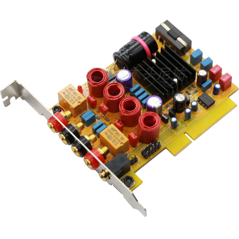

PC board!?!
Oh no nooo, another board, and another pcb color :drool: :D
This 3116 fever actually has its 'official' version: Genuine Fever computer TPA3116D2 digital amplifier board
It needs just a free PCI slot :banana:
