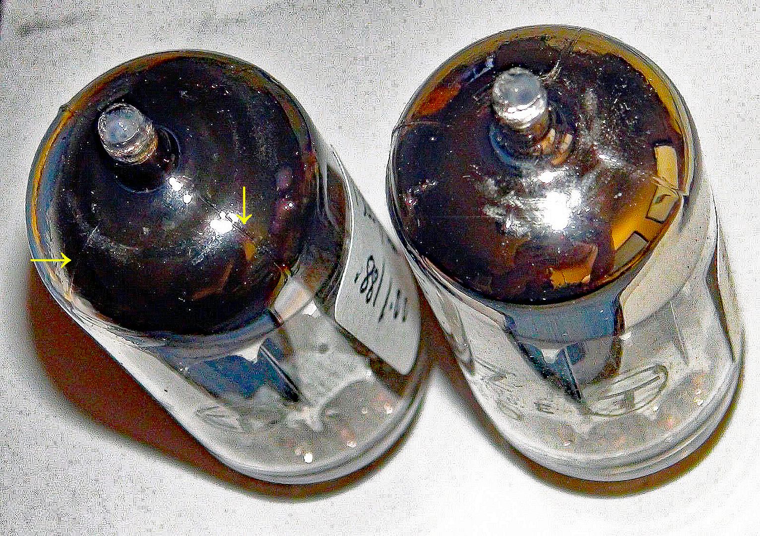

Another tube I.D. needed.
I found this one with some other tubes I have. There are no markings on it. Not sure if it’s a 12ax7, 7025, or 5751 or…..
Thanks.
ive got a good idea of what you got, but the pics are very dark. can you please post 5 more or so going around the entire tube except the top and bottom between the pics, well-lit and clear with no glare to see the entire structure?
of you could, please, i would like a clear, well-lit look at the pins as well, but not lookin strait ahead at the base.

Thank you folks for your research and feedback. I have had an amp that had a/some Matsushita tubes in it, it’s been a while ago, so I can’t remember which one it may have come out of. So it’s a fairly good possibility it is a Matsushita.
Has it been confirmed it is a 12ax7?
Matsushita 9-pin minis usually have two cross-hatched seams at the top of the tube. :idea:
