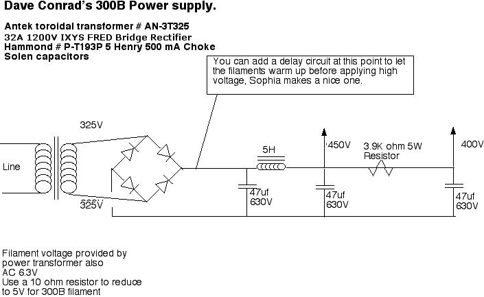

Actualy ,the limiting factor for current is the rectifer tube and the power transformer ,use a toroid and solid state rectification to gain more current and then add all the caps you want .The amp i'm building has a one amp toroid per channel for the B+ and and 1,400 mfd for the first cap , five times the current the output can draw .
QFT. Not necessarily using a toroid (it's not mandatory to do so), but simply start out with a clean slate... heavy transformer of whatever appropriate type, good solid-state rectification (Schottky diodes preferable), a good choke, and as much cap as you can stand.

Interesting thread. To me, power supplies are very important, and one of the best places to get "bang for your bucks" from simple mods. The only place I ever use a resistor is for the front end B+ where current demands are small. Low resistance chokes are the answer for me. Most of my power supply thinking is pretty much off the wall, so I won't go into it.

Hmm, that last line made me think.:D When I can buy a diode with "0" recovery time, 10amps current capacity, and 1200vpi for 10 dollars, that pretty much makes my mind up. I can understand how some folks want to use tubes, and that's cool too, I just ask myself what I need the supply to do, and sand wins out nearly every time. Sometimes the 5v filament winding can be used for other stuff, like relays or LEDs, but even if you just leave it capped off, you are taking "some" load off the TX, and that's usually a good thing when using iron out of commercial stuff. As for big inrush with SS supplies using loads of capacitance, a CL 90 is very affordable and works great. I'm looking over at the amp on my bench right now, and it has 9400uf sitting on top of the chassis. It is definitely getting 10 amp diodes and a CL 90 in front of the PT.
For your consideration is this supply for my 300b amps. Set helped me out with this one, works fine.
