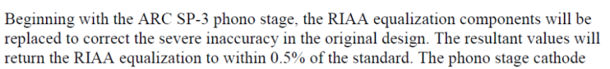

A fellow AK'er sent me a great project . . . he had purchased a premium ARC SP3 preamplifier that had been "modified" [somewhat] according to Curcio Audio's recommendations, which included changing the phono RIAA curve to "correct the severe inaccuracy in the original design;" removing the phono stage cathode follower which is allegedly "responsible for serious veiling"; the line amplifier was accused of being non-linear and noisy (the reconfigurer omitted Curcio's "power supply regulator" that he claims will "deliver a truly neutral and sonically inert power supply.") There were also other functional issues, yet to be plumbed.

AFAIK Curcio hasn't revealed his test setup for the PAS; nor were "before and after" plots and curves of the mods provided with the the SP3 mod instructions. I disagree with the removal of a CF for a 12AX7 phono stage, so I decided to take all of the recommended mods with a grain of salt and try to restore the unit as much as I could to its original condition so that the other issues could be dealt with (with the exception of changing the large cans in the power supply and adding smaller 0.1 MFD bypass caps).

Curcio's work was debunked long ago...

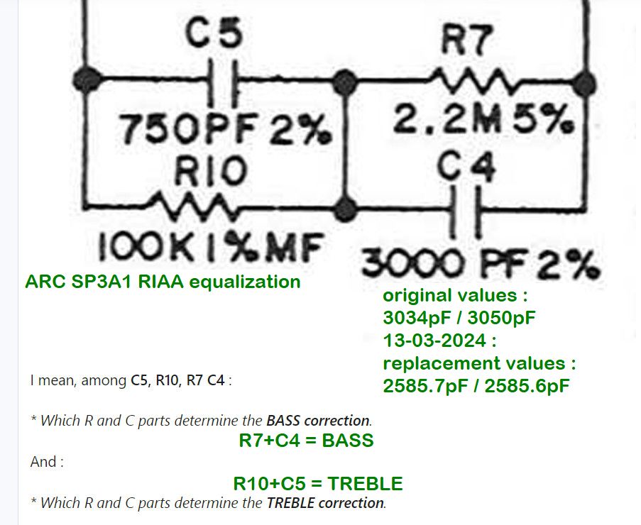

With a slight modification of the RIAA network of my SP3A-1 :
I came to these results which I found very satisfactory - for me, at least ;):

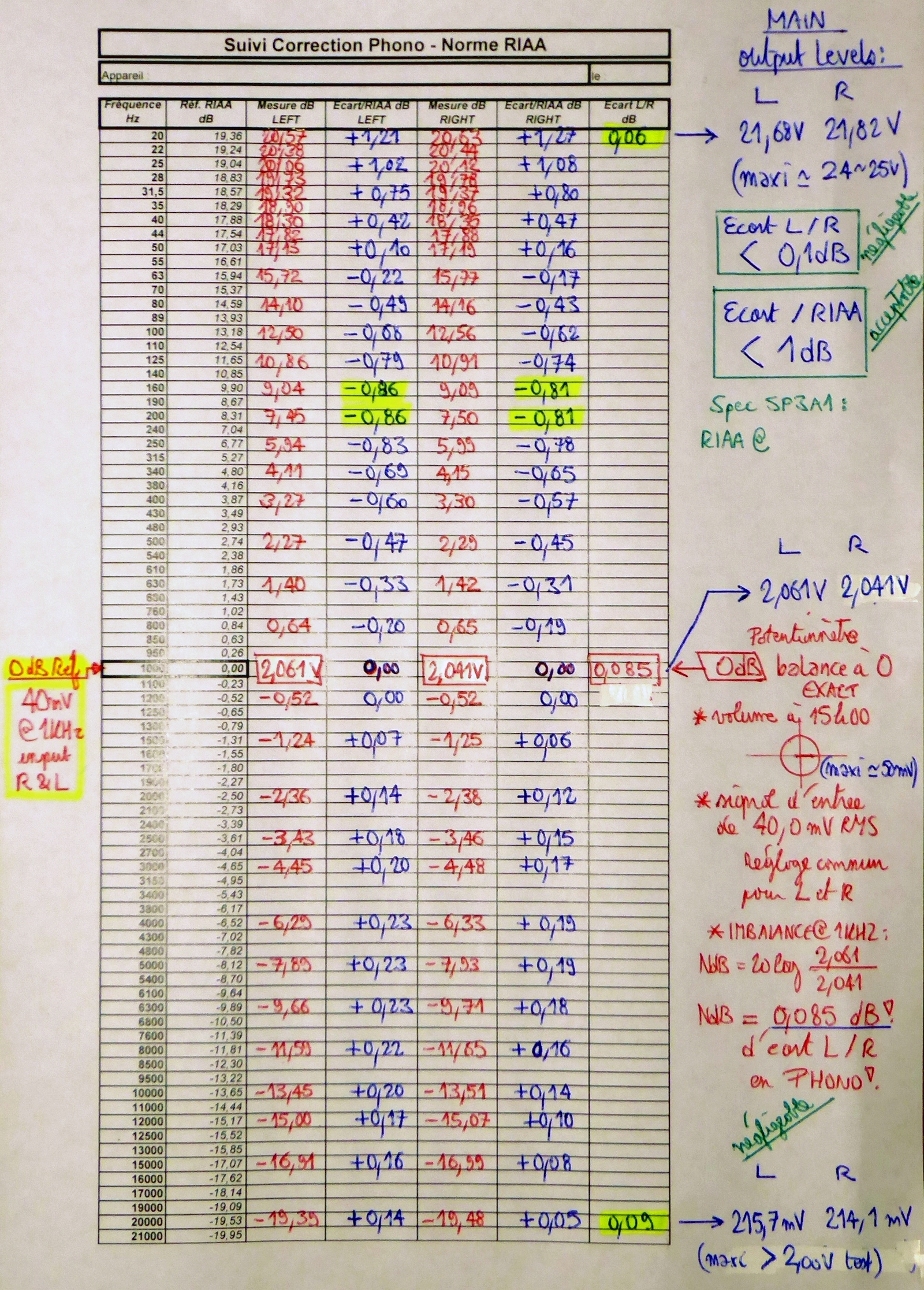

What do the "before" numbers look like? I'm just curious how much of a change this makes. Looks like you're up about +1dB at the bottom, and I'm assuming in stock form it would have been down somewhat?

This schematic was posted earlier in the thread. Is it the correct phono circuit for the preamp under discussion? Which tube types are being used?
Here they are - handwritten, sorry. No huge difference, of course... Let's say that I "recalibrate-rebalanced" the RIAA equalization (see post 53 for the recalibrated measurements, in the same conditions) :

At a quick glance, it appears your changes made the most significant improvement in the area very generally around 150Hz to 400Hz. Is that correct? I have to say, the original response isn't too bad, probably flatter than most cartridges. That's especially likely if cartridge loading hasn't been properly matched on the bench with a test record. "Normal" loading can easily skew upper frequency response by 5dB or more due to cartridge inductance.

thats the info I was curious about, so easily flat within 1.5dB in stock form and under 1dB from 28hz to 20K. Hardly what I'd call "significant" or whatever spooky language Curcio used to describe it.
