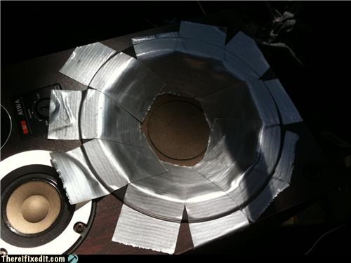

I don't know why you would think that. Using anything other than the proper butyl compound on cloth surrounds is a lot like using duct tape to replace blown out foam surrounds. Some may think their speakers still sound "awesome," but they would be wrong. At least the duct tape can be removed and proper foam surrounds can be used. Using corona dope, latex, or other "stuff" will ruin vintage speakers as noted by Retrovert

Instead of claiming surround treatments are somehow a matter of opinion, consider the history:
(1) You posted a recommendation to coat surrounds with corona varnish as if this suggestion were factual, tested, and credible, and if it worked better than the butylene-rubber dopant under discussion.
(2) I took the time to explain why, from a science and engineering perspective, including actual test results, why the proposed product was totally unsuitable, as it would instantly and irrevocably destroy a vintage speaker just as would any other hardening surround treatment.
(3) RTally explained why guitarists want distortion, and that this was a different goal.
The issue has nothing to do with flame wars or speaker cables or opinion. It has to do with promoting a product which is 100% guaranteed to destroy the sonic characteristics of a vintage speaker whose surround was originally coated with a soft, pliable, non-hardening (for decades) rubber. How could a hard treatment be beneficial? No speaker uses such a treatement, aside from guitar speakers which are treated to destroy the sonic characteristics to increase distortion.
I suggest taking the time to read the extensive discussion — including the quotes, summaries, and links I FIVE YEARS AGO posted — set forth in this very thread, as above linked to by me, as well as RoyC's writings here on AK and on ClassicSpeakerPages, all from years ago. He did the entirety of the necessary heavy lifting, having performed actual experiments and measurements, including ones taken over time to show the hardening of various cements and caulks.
I explained, in great detail, the science and engineering behind surround dopants, the material composition of the product you suggested as being a beneficial and suitable dopant, and why all hard dopants are destructive. Not an opinion, hard facts.
Thanking me for saving your speakers and those of others would be the more appropriate response.
