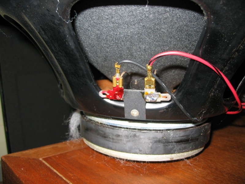

Wow Ken! That's surprising. You should post a pic or two of that driver if you have a chance.
Just finished the refoam (successfully) of both of my Watkins 12" drivers last weekend, using Rick Cobb's surround kit. My woofers are indeed 2" VC poly cone drivers with a slight bumped back plate. What I found most difficult was centering the coils with the 30hz test tone. Whoever originally glued the cone to the spider didn't align them properly, so in gluing on the surrounds it was necessary to force the cones off-center to the baskets about 3mm. Both were nearly identical in that respect. My guess is that the jig used was off that much. Thankfully they're working nicely now. :thmbsp:
I will do that (get some pics) soon and post them. Unfornutately I tossed the one away since I was told it was unrepairable. I had purchased a replacement for it and the one I purchased was indeed the same as the one I tossed, same large Magnet assembly. Maybe they were made later and were used to supply bass drivers for RS 4.5's as I am not sure what their bass drivers looked like but were probably some of the latest versions of DVC made for Infinity These were in a pair of QLS-1's that I purchased and repaired all the drivers that had problems, both the bass drivers were of the type that I described, poly coned, silver magnet assembly and baskets. One of them just needed the foam replaced, but the other one had major voice coil rub so I purchased one off the internet that looked brand new from a guy and it matched the other one, and is working great. But most of my other QLS drivers with the same part number on it are different looking, they have black magnets and the magnets are slightly smaller than the back of the basket.
This is a pic of one of mine from the Q2 - smaller magnet I guess and paper cone
