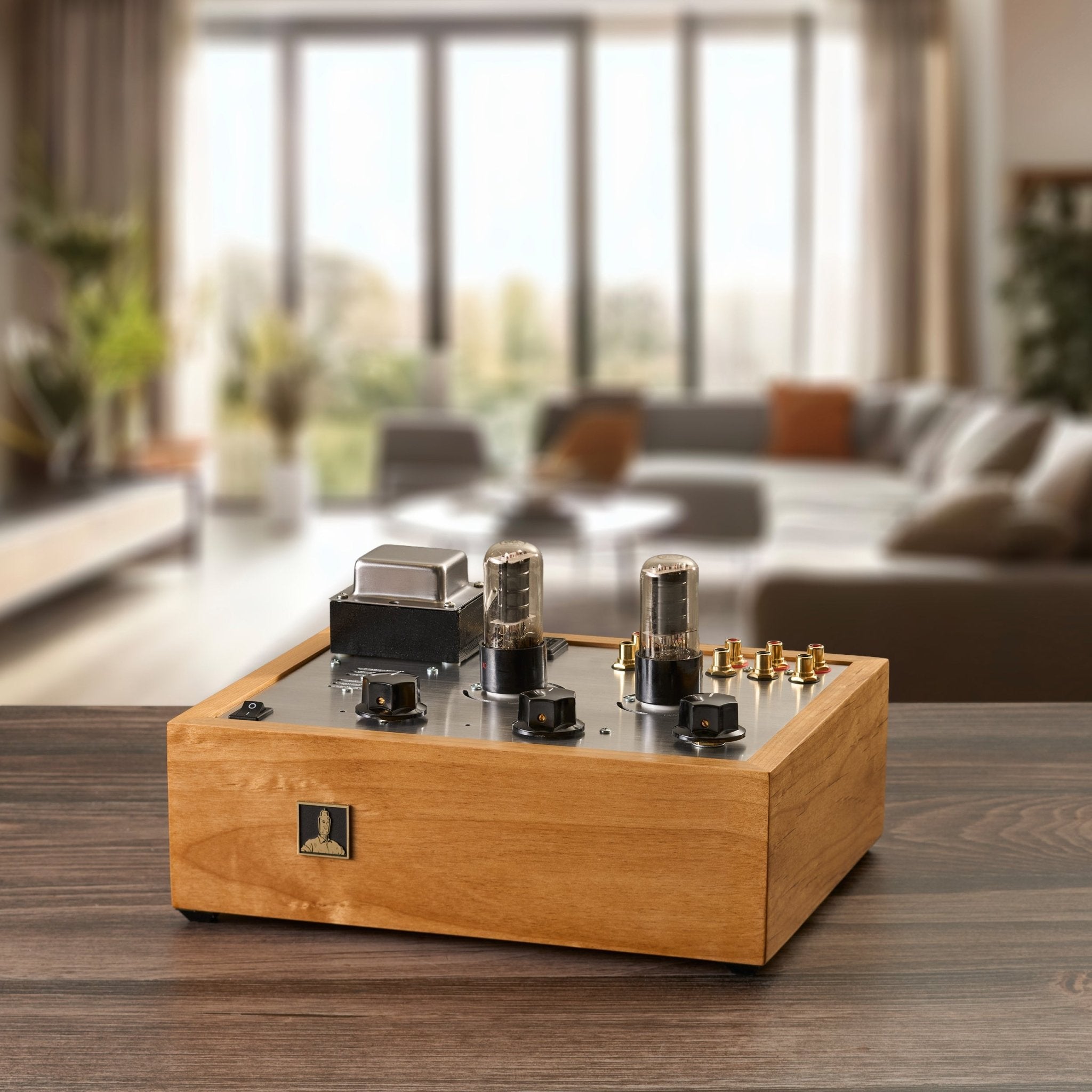

I will try to build my first ever kit. Currently I am practicing soldering.
Please advice and thank you.
Which kit would sound better and easier to build...
TIA
Just looking at both kits I would personally go for the Moreplay.
Unless you need that solid state phono preamp that's built into the Elekit preamp.
The TU-8500 published numbers for SNR are much better than the Bottlehead. I'm not sure I believe those numbers. I have a TU-8500 and it works fine. Is it the bee's knees? Not really, but it does everything it claims to do.
Yeah, really kind of apples vs oranges. Moreplay would have a much higher output impedance, if that's going to be an issue. Will most likely respond to tube rolling, whereas the TU-8500 probably won't sound much different. Completely different form factors too.

What amplifier?
Moreplay will work better with high input impedance amplifiers - most tube amplifiers and some solid state amplifiers.
I got the Elekit 8500 and it has the mundorf caps, better resistors, and better OP amps in the phono, better 12au7...really nice preamp and phono. Easy online upgrades.
