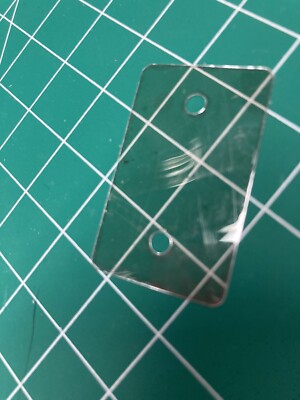

Fired up great off of the DBT and idle current dialed in nicely. I accidentally destroyed the mica pad last week when I took everything off so I used some thermal pads I have from PC building to mount to the heatsinks instead. The smaller devices got a shot of Artic Silver thermal paste. Everything is cool to the touch.

Those isolators you used look pretty thick, Id go with original micas to make sure the heat sink gets the heat transfer so the outputs don't fry .
