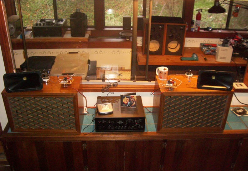

Here's my latest EWG implementation. Pretty standard fare for EWG houserockers. :thmbsp:
And here's a snap of the Christmas EWG that I set up so my folks could hear what I was working on.
That's one of my dad's AR2's that he gave me when I turned 15 that I had stashed in the basement.
Ok so how do the 99a's sound on a scale of 1-10. What were they before
and what are they now. I am not being nosey but I have mine stripped
out for rebuild. I have commited to e wave my hpm 100's and already
have the crossovers built and drivers in. I ordered my waveguide horns
last tuesday and still no box on the porch.I guess I will know soon
enough on the hpm's. I always thought the woofers sounded ok in
the 99a's but the other drivers and or crossovers had issues.
Hey Jack,
CS99A's before would get a 5 or 6 out of 10.
1. Nice finish, classic 70's styling.
2. Good workable bass
3. You can really turn them up if need be.
4. They're just fun for what they are.
5. HF and midrange doesn't integrate all that well. Feels like you're listening to disparate parts..
C99A's after get a 7 or 8 out of 10.
1. The bass is still there and they still look good
2. HF precision is there and it sure is amazing. It draws you in and keeps you listening.
3. Seamless integration with LF
4. Bass isn't as deep as the JBL L100 woofers used in my first EWG project
5. Bass isn't as deep or as accurate as the JBL LE14A woofers from the C36 EWG
You could do a lot worse than to do a temporary mod to your CS99A's. I might just keep listening to it as is. It just works.
