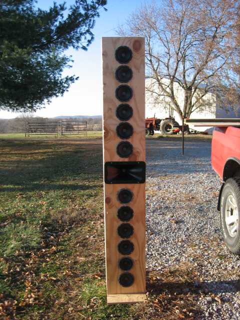

On first iteration I used the standard <95 crossover. I hadn't really figured the sensitivity gains, IOW I didn't think it through and guessed wrong. I have to run the tweeter wide open in that config to get anything approaching balance. I need to rebuild with the >95 XO, just haven't had time. I need to do some tuning on the low pass as there is way too much going on at the XO point. These are actually mids, after all. As a line array they do have pretty good bass but I have to tweak out the XO and build the other one to really get a read on them.
