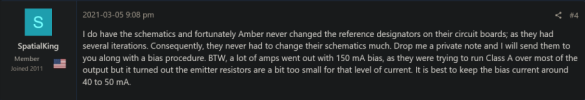

post #348 above specifies why setting to 150ma is a bad idea and how 40-50ma is the correct value.
