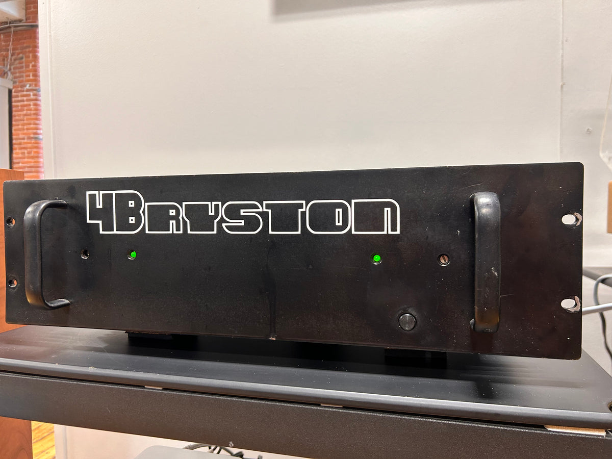

taking a look inside the bryston. system is functional, one channel had most of its outputs replaced at some point in time. the other channel looks original, no signs of a recap or extensive circuit changes/repairs/modz.
modular channel removal interesting to see. unfortunately desoldering components requires removing all the output transistors which is messy. i wonder how many amps the sliding pin edge connectors are rated for. definitely going to need contact enhancer to reduce junction resistance for improved output.
