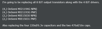

pair of 470uf caps are in parallel as shown in the schematic snippet posted earlier. the update/modz solution will involve a 1000uf in parallel with 8uf film as a thermal shield/barrier wall. not to mention the pairs of 1w resistors will get a wattage rating increase.
havent decided what to do with the 180r offset situation. possibly replace with 0.1% 1k and then modify resistance with a parallel value (220r +/- ~r) to dial in a near zero offset or something. need to complete the primary rebuild first and then adjust the system from the new stable baseline, if needed.
larger value resistors have higher thermal noise component so maybe a multi-turn 200r pot + 100r 0.1% would be better. balancing the two narrow boards per channel might increase complications i.e. too many variables.
