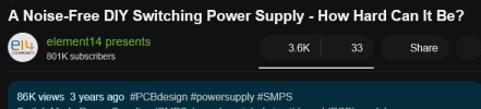

Screenshot 2025-12-30 at 22-23-01 A Noise-Free DIY Switching Power Supply - How Hard Can It Be...png
youtube.com/watch?v=ojB2gC0o7bg
wandering around the tube and bumped into diy smps random thoughts. plus a few products on the market for class-d amps that are making the rounds on the usual review sites (free marketing).
