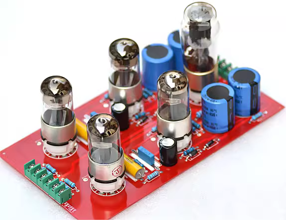

obviously not using the 5v mains input for the tube rectifier, so a 6550 is parked in its spot just for kicks. the large 150uf blue electrolytics in the website product photo have been replaced with smaller film, under the board. more than a few of the factory resistors have been upgraded plus a few values changed. another frankenstein project.
no new holes were drilled in the scrap donor chassis. utilized preexisting mounting locations plus one spot needed some hot melt glue which didnt stick very well. board metal standoffs also from the scrap pile, angle bracket for iec mains plug also a random piece of the convoluted puzzle.
