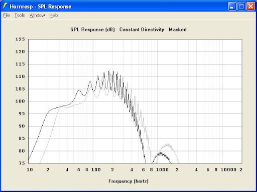

dims increased to 20.75"x20.75"x10.25".....but response is nearly identical. Looks like a 1/2" MDF purchase is now in order...
And, since I had to increase the size of the W6 loaded Insubnia for 1/2" MDF, I looked at the W8 for a slightly bigger horn, but still only 24"x24"x12".
Here they are both simmed corner loaded, 2V into each (W8 Insubnia in grey):
Now I only wish I had real measurements for the W8 instead of using the fatory specs....maybe I'll have to order one...
