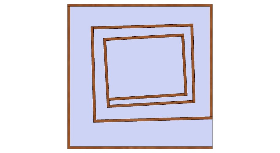

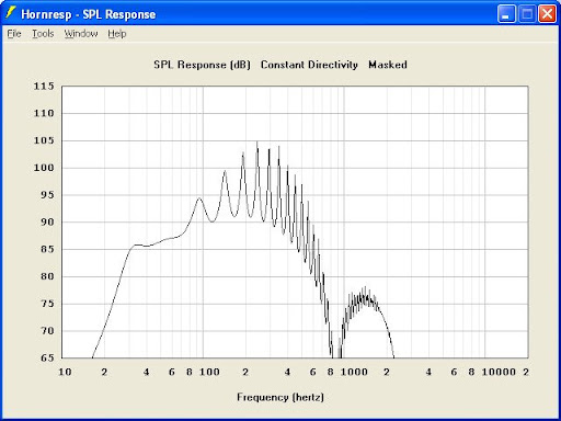

Reworked the OD FLH Insubnia, with lilmike's measurements of the TB W6-1139SI driver...
Layout:
Hornresp sim, 2V, 2Pi:
Final dims, with 3/8" MDF throughout: 20.75"x20.75"x9.5"
Corner loaded, Xmax limited at 25Hz, 15V in, gets you 115dB from 30Hz on up according to hornresp...so it can be assumed that you may be able to get a clean 105dB from it when corner loaded...highpass it, and you can get a few more dBs....the driver is on it's way....so I'll be making sawdust soon...

Wow - 3/8"?
I can barely get a brad nail into 1/2" material. Are you planning on routing the side panels or butt-joining the cabinet together?
probably butt-joins, I am pretty good with a brad gun...it would take a little bit of time to generate a template for routing the sides...but it is a good idea.

Are there calculations that will give the exact angles for all those interior joints?
I dont think that would be necessary. Once the size of the unit is known, measurment would allow you to place the first interior board (by messuring top to bottom , side to side ). Notice the illustration shows how t he individual boards are butted up against each other? By placing the next board ( of known length ) in position against the first, you would need to know the distance from its end to the edge of the bottom piece your attaching it to. ( and of course the length of each board) And continue in that fashion until finished. Mount driver and wiring, electronics etc. Then put the top, (Identical in size to the bottom piece) and its done.
You would need to know the dimensions of the "bottom" piece. The top to bottom and side to side measurements to place the first board, and its dimension. Then the measurement from the end of each successive board to the side wall its against.
since this measurment is taken from the tip of the successive board, the angle would be set.
PS The "first interior board" didnt get explained, in the illustration put your pointer on the outside board at the top. If you slide straight down, the first interior board or panel you hit is the one I'm talking about attaching first.

The way I typically build front-loaded horns is to accurately lay out the entire fold pattern on the side of the cabinet, then attach the boards working from the center out. The first boards installed are usually the baffle or the side of the back chamber that the baffle attaches to.
Tapped horns are similar, except the first board is the baffle. I use brad nails or screws, as appropriate, and polyurethane construction adhesive. Clamps and squares help a lot.

As I see this design, the width of the passageway is tapered, that is, it gets increasingly wider as it spirals out from the center. That is evidenced by the fact that the central 'box' is twisted in relation to the outer case. In order to do this, each of those right angle joints have to be slightly greater than 90deg, except for the first joints on the central box and the outer case.
If only the length of each panel is increased, the sides of the spiral would all be parallel to the outer case. Each section would be wider than the last, but there wouldn't be a gradual taper as shown in the diagram. As I understand the theory, that is the purpose of the design.
Granted, the angle would only be a degree or three, and caulk might be sufficient, but considering that this will be used for bass, rigidity should be important, which comes with solid joinery.
Maybe I'm just seeing this wrong... :scratch2:
