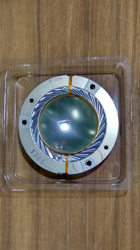

One is playing softer than the other one, and first I thought it’s because there was/is some corrosion on the diaphragm, which I cleaned out (nerve wrecking; felt like what neurosurgery must feel like; had never done this before and felt like I can destroy the thing any second all the time).
This one:
But then I opened the other 2405 to see if there’s any corrosion, too, and saw that it’s a completely different diaphragm? I guess? This:
It didn’t look corroded and the phase plug stuck to it, so I didn’t want to risk damaging it and put everything back together.
Long story short: maybe the blue one is playing softer because it is a different diaphragm altogether? Because of the corrosion? Weaker Alnico magnet?
In the end I’ll probably just ignore that one is softer and go ahead integrating it regardless.

If the blue diaphragm is JBL, it would be from an 077 with the lucite wedge, not a 2405. I don't know that there are any other differences other than the color, but blue diaphragms are made of unobtanium.
There is something else that can and will change the response of these tweeters, and the 075s, and that is the diaphragm installation. The tightness of the screw can have an impact. But even more so, when the screw is put in and the phase plug tightened, if there is ANY twisting of the diaphragm, the impact can be huge.

Interesting! So no 2405 ever came with a blue diaphragm from factory? I did pay attention to holding the phase plug tightly while fastening the screw to avoid any twisting, but having no experience with this I don't know if I did it correctly. Nothing changed significantly from before opening it up – neither to the better nor the worse – so I assume the person who messed with it before me did the same mistake, or maybe more likely, the two small dents and the damage from the corrosion (which I cleaned up and tried to prevent from spreading further) are at fault for the softer output compared to the other 2405? Maybe just a weaker Alnico magnet?
Here, by the way, is the other side of the blue diaphragm:
I don't know that there were any differences, other than color, one way or the other. That would be a question for the JBL forum, but even there you may not get a valid answer. I do think that the parts sheet specs the 2405 diaphragm as the replacement, but replacements are not always exact and subject to change over time (e.g., 2420/2421/2425 diaphragms).
It is interesting that the replacement diaphragm for the 2402 is listed as the 075, but I guess this makes sense as 075s were made long before 077s, 2402s, and 2405s.
BTW, the two dimples are typically from careless handling of the lead wire horseshoe clips. These are ferrous and are drawn to the magnet if they get close, and if the diaphragm just happens to be in the way..., voila. This is a common sight on the horn driver diaphragms and the two ends of the clip leave a pair of "vampire bites" in the aluminum, though typically not audible. Be careful here!
You get the idea! These are expensive diaphragms (original 375 in first pictures).
