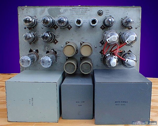

Hello Soundmotor - thank you for the information and tips. The 6446 on the Antique Radio website has tan based transformers. The picture is too lo res to be very helpful. I did just find other examples tonight on a Japenese and a Taiwan site. I can see the numbers on the transformers but again the images are lo res and I can't make out the numbers. If I was familiar with the Ampex numbers I might be able to make a guess. I'll try to post the pictures later in case someone else can help.

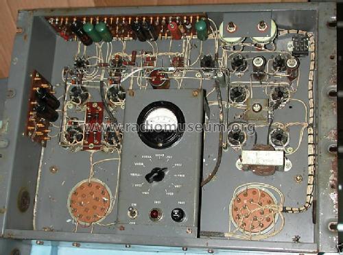

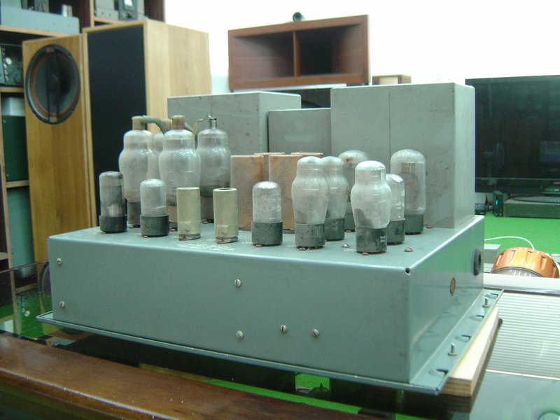

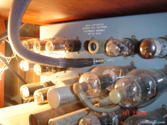

Here are the new pictures that I found on Japanese and Taiwanese sites. Do the pictures of the output wiring or transformer numbers look familiar to anyone?
Seems there were at least 2 versions of this amp. Mine has steel "feet" added to the transformers. I do not have the tube base clamps and the chassis layout is different.
