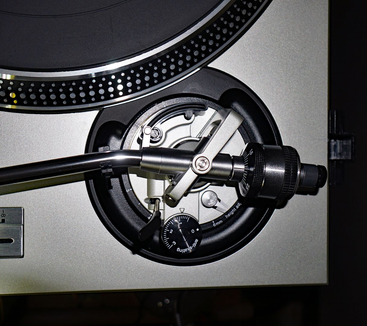

Antiskate force , what is yours
Antiskate force at setting at 2, for 2 gram VTF

I like your poll about the actual antiskate force in use with the dial set to 2. I think I still have a digital stylus force gauge around here; I'll see if I can locate it and add to the data.
Edit: I found my scale, and it read .62 grams at an antiskate setting of 2 on an AT-LP120XUSB. Grossly high, and maybe my cheap scale isn't working well for this, but maybe not surprising since I had the antiskate at 0.5 on the dial following Soundsmith's method for setting antiskate for the VM95C tracking at 2.1 grams. If my scale is accurate, This AT, a different sample than the one I mentioned in the post above, must be calibrated even worse than the one I had before. It jumps a lot at low settings, measuring above .3 before the dial even got to 1. I'm thinking about a U-Turn Orbit, which has a fixed antiskate of .25 grams, so I used my scale to set that just to see how I like it, and I only needed to move the dial to 0.6. Oh well, that's the beauty of the Soundsmith method--you adjust the antiskate to get a particular movement of the arm in the runout area, and it really doesn't matter what number the dial is set to.
