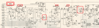

She's alive, but not happy. Clearly more work is needed. Here are the problems and symptoms I'm seeing:
1. It's outputting a fine static, almost like white noise, like you'd hear on an FM radio with no signal. The volume knob works to increase and decease the static, but there's a base level of noise even with the volume all the way down.
2. One of the two 12AX7 tubes lights up immediately at power on, and then dims down in 2 or 3 seconds. This problem follows the tube if I swap it to the other socket, but it doesn't light up as bright in the other socket. I may have a workable spare I can swap in but I'll have to check.
3. The static is on both channels, but only one channel of treble and base control has any effect. (this unit has independent L and R treble and bass controls). It might be too early for this to mean anything
4. I could not get an audio input signal to appear on the FM, tape, or aux inputs, although the RCA connectors do not offer firm physical connections so I need to test the contInuity on them, or wire something in directly.
5. The volume knob is still really noisy/scratchy so my cleaning job was not extensive enough.
The power indicator and speaker indicator lights all appear to work. Small step forward. I may have to admit failure and take the thing to the local repair guy who works on vacuum tube equipment :) However I am not opposed to troubleshooting the thing.

Is it a European tube? Many of those are known to flash on power-up. Nothing wrong with it, just a thing they do.
without a schematic I don't know the full signal path here but since the volume control doesn't stop it, at least some of it must be coming from after the volume control. If there is a tube immediately downstream of that, try pulling it and see if that stops it.

I made some progress:
1. I realized I had never cleaned the "balance adjust" potentiometers which are in the output transformer sections. So those are cleaner now.
2. I re-cleaned the 4 volume pots.
3. I checked continity from the AUX inputs to the output side of the source selector pots and that path is good.
4. I swapped the 12AX7 tube for a "strong" spare and that made no difference in sound, but it doesn't flash on startup.
5. I bypassed the normal speaker terminals as Gadget73 mentioned, in order to rule out flakey speaker select circuitry, however that did not make a difference.
Now what is happening:
1. The FM radio static comes and goes, and a 60 Hz hum comes and goes.
2 . I did get the thing to play channel #2 of audio with the volume knob at 100%. Anything less than 100% and I was getting static and popping. 3. After about 10 minutes of music from channel 2, the thing returned to humming and scratching and the volume knob even at 100%.
4. Audio from channel 2 is somehow making its way to channel 1 speaker.
So I think the volume pots are junk, and that could be the source of the missing channel 1 audio. Holy cow, replacing the 4 gang volume pots will be a chore. These are 100K pots.
Great idea. I pulled the two 7247 tubes (V3 and V9). These are just after the volume pot and right before the power amp tubes. This cleared up all of the static and popping but I am still hearing a very low level hum on both channels equally. That may be the least of the problems right now.
low level hum might be the balance pots misadjusted. This doesn't have a direct way of adjusting it with a meter, but if you adjust them for minimum hum on each channel, its where it belongs. That will be equal current flow on each channel. Whether its the correct amount of current flow is a different question. May as well do that with the 7247 out since its otherwise quiet now.
Try grounding pin 2 on V3 and V9 with them installed and see if thats quiet.
also if you haven't, clean the pins and sockets for the small tubes. Inter-dental brushes dipped in whatever contact cleaner you like do a nice job on sockets, a magic eraser does well on pins. Just make sure its fully discharged before sticking anything into the sockets.
