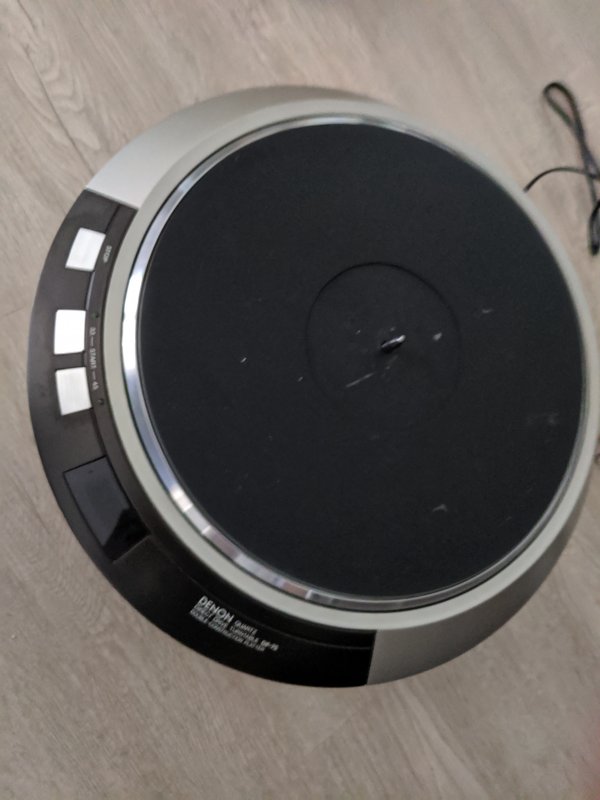

Best description is....Used.
buttons for 33/45 are sticking and the 50hz /60hz is missing the button. But it turns on and has a generous amount of torque.
Still waiting on arm and on the list with spence for a plinth
I wouldnt buy that missing buttons and sticking. So a SNAD return. Not for that kind of money.
