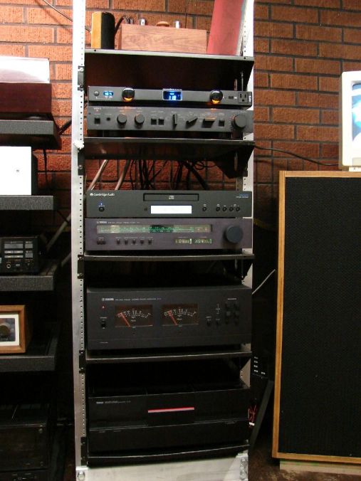

My basement rig is Yamaha gear with Polk 7A's. I need to replace the tuner signal strength bulb and build a rack.
TC-320 cassette
CT-800 tuner
CA-800 integrated
YP-D10 turntable w/AT440MLa cartridge
